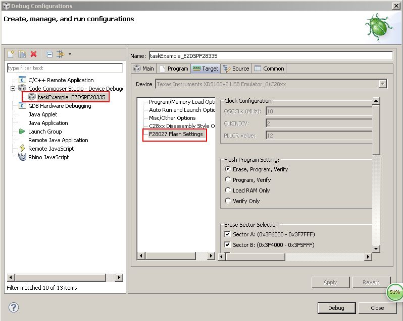

When I use XDS100V2 Debug my F28335 board, it does'nt work because of device mismatch!
Other Parts Discussed in Thread: TMS320F28027, TMS320F28335
How to change 28027 into 28335? I have select 28335 device while newing the target config file.
  • When I press DEBUG,the console info is:
    C28xx: Flash Programmer: Warning: The configured device (TMS320F28027), does not match the detected device (TMS320F28335). Flash Programming operations could be affected. Please consider modifying your target configuration file.
    C28xx: GEL Output:
    Device Calibration not complete, check if device is unlocked and recalibrate.C28xx: GEL Output:
    Device Calibration not complete, check if device is unlocked and recalibrate.C28xx: Loader: One or more sections of your program falls into a memory region that is not writable. These regions will not actually be written to the target. Check your linker configuration and/or memory map.
    C28xx: GEL Output:
    Device Calibration not complete, check if device is unlocked and recalibrate.C28xx: Can't Run Target CPU: (Error -1041 @ 0x3014B1) The emulator reported an error. Confirm emulator configuration and connections, reset the emulator, and retry the operation. (Emulation package 5.0.872.0)

    I have to clean and close all project and new a target configuration file again and again. sometimes it is ok, sometimes it is wrong. so have to import this example project from TI explore again and new target configuration again. then I have to check the project property->build and see the flash device type is what I set.
    I don't know why it is ok or not.
    Maybe I had tested a demo project based on 28027 before and some configuration is shared?
