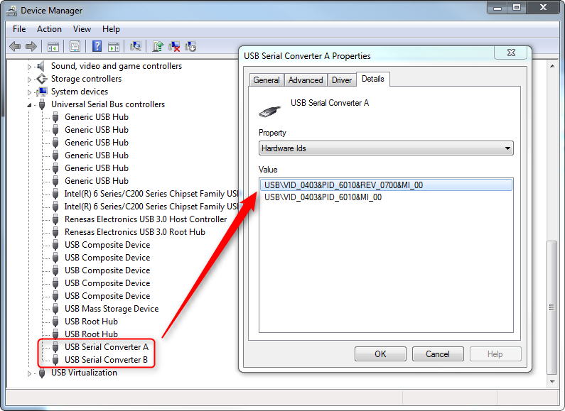

I cannot get debugging to work with CCS5.3 with my AM335x starter kit.
I  followed advice in another TI column that stated to use Mprog.exe 3.5 to flash the FTDI device to use ProductId A6D0 instead of 6001.
I did this, and now i get 2 "Texas Instruments XDS+Rs232 V1.0" devices in Windows device manager with no known Windows drivers (I am using Windows 7).
I then saw another column that stated that the TI  AM335x starter kit should use ProductID 6001 and *NOT* A6D0.
2 questions:
1) Which ProductID is the correct one to use with the AM335x starter Kit?
2) If it is 6001, does anyone have an ept file with the correct settings for the AM335x starter kit, because I will need to reflash it with Mprog.exe in order to use it.
Thanks!
Clive

  • Clive,
    I think the Product ID you are trying to use is incorrect. The AM335x Starter Kit should have come with the standard FTDI's VID/PID (check the attached screen with my board connected to the serial port) - i.e., VID = 0x0403 and PID = 0x6010 (no 0x6001)
    To help clarify the differences, check question 6.5 (and 6.6 in specific cases) of the CCSv5 FAQ.
    Hope this helps,
    Rafael
  • Thanks.
    Do you have an ept file so I can re-flash my board to use the correct PID?
  • Clive,
    Please check the Template file I got from my board (AM335xSK Rev 1.2b). If your board revision is different, try at your own risk (I am not sure if this is compatible with all SKs).
    Rafael

  • Thanks!
    My board was also Rev 1.2b, and flashing it worked. When I plugged it back into Windows, It used the standard FTDI driver.
    However, my problem is now that I am getting a very flaky connection within CCS 5.3 to the starter kit board.
