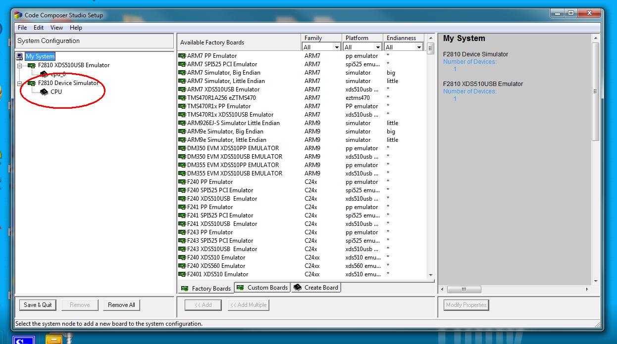

  • Ok quick update -
    Our IT folks are hesitant to disable the AV and firewall because they say it was all configured carefully so that it couldn't be disabled but they are "looking into it."  I suppose one thing that helps our case with the A/V is that I have built the project successfully before offsite using the same computer, which had the same A/V running at the time.  The network situation was different though, I was no longer behind the company firewall but at that time I didn't have the permissions to turn off the windows firewall either so it was on during that time when it worked...Perhaps we can do a TI conference call with our IT group if we want to pursue bringing down the company firewall for a test as its over my head at this point.
    The other guy using the V3.3 of code composer gave me the pointer to try out:
    "Try using the simulator CCS setup, not the emulator CCS setup." but I'm not sure what he means by that or if it would have any effect.
    He is suggesting you try a simulator setup instead of trying to connect to real hardware. This is not the issue, you are getting build errors, not debugger errors.
    I think we may have tracked down the problem to the target configuration setup.  When I was doing development at the other location I had an emulator attached to my laptop and the TI chip.  Over in this office I don't have that available so its trying to use my target configuration for the build assuming I have the same hardware setup available.  Unfortunately its not practical for me to carry around that emulator, harnesses, power supplies, and the controller board for me to compile so I took a look at the other guys setup (thats using CCS3.3) and he had the following 2 configurations - emulator and simulator.  I only have the emulator.
    To rule this out as the problem I wanted to install the same simulator.  By default I couldn't find it in my CCS5.1 target config options.  Wasn't able to find it on the TI website.  We even exported his target configuration and tried to use the import feature to bring it in that way.  Problem was though that his system's simulator export is extension .ccs and my CCS5 is wanting a .ccsxml or something similar input.
    I can't seem to find or copy over the simulator to rule out this possibility of being the problem though.  Do you think it sounds like this might be it?
    I can still pursue the firewall/AV idea also.  That simulator has to be somewhere though...
  • I really can't imagine that the target configuration is the issue. CCSv5 works differently than v3. With v5, you can open the IDE without the debugger being launched. Your errors are build errors. There is no correlation with the target configuration (yet). Anyway there is only one 28x simulator that ships with CCSv5, a F283x CPU simulator. No other simulator is supported. But again I seriously doubt that is the issue.
    I feel more strongly that there is some permissions issue. Some security software running on your PC.
