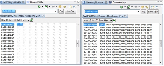

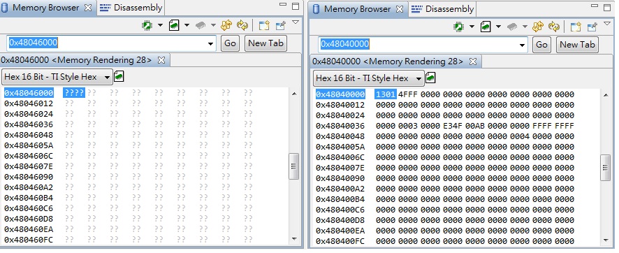

Hi TI team,
    we would like to set the timer 5 & 6 of AM335x,
    but always fail.
   and then we found we can not access the registers of timer 5 & 6(the register address is 0x48046000),
   but the register of timer 2 (the register address is 0x48040000) can be accessed.
   and also CCS can not access the registers of timer 5 & 6.
   are there not the registers of timer 5 & 6 with AM335x?

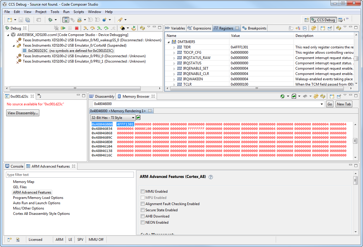

    The Memory browser view is not selective on what contents it displays - it only shows the memory contents at a given address. Therefore I think that the referred timers are simply powered down (check the attached screen with both the registers view and the Memory browser showing DMTIMER5 in CCSv5.4).
    Several peripherals only have their registers visible when they are powered up and enabled, therefore this may be the cause of the error.
    Hope this helps,
    Rafael
