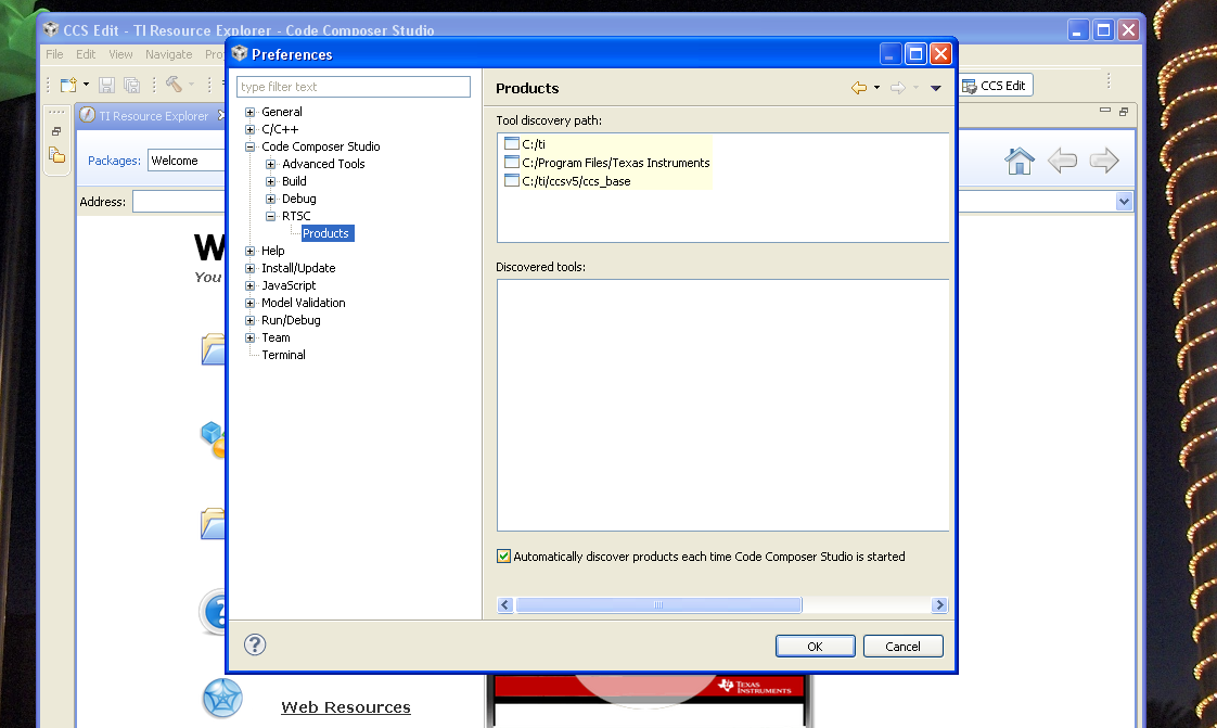

  I installed CCS 5.4.0.00091  and afterinstallation I see that the xdctools package is not being found. I performed a full install and there were not issues during installation. After installation when look at the 'Window->Preference->Code Composer Studio->RTSC->Products' the discovered list is empty ( ). I re-installed both SYSBIOS and xdctools and this did not help.

  • LIsa,
      After I installed the NDK package you recommended, I still do not see CC discovering the newly installed package (or any others).
    The only package it discovers is C:\ti\ccsv5\ccs_base\msp430\msp430ware_1_40_00_26
      When I do select this to be added it fails with the following error.

  • Hi Baltasar,
       Yesterday I renamed the existing "c:\ti" folder and re-installed CCS. After the installation CCS was able to discover the XDCTools and SYSBIOS (that were installed along with CCS) correctly. I installed other packages and it was able to sucessfuly discover the installed packages.
       To me it looks like the un-install of the previous version of CCS was incomplete and left behind some residual files/folders which was causing issues.
