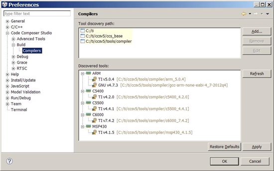

    The best way is if you go to Window->Preferences->Code Composer Studio->BUild->code generation tools
    This is the best place to add and manage your compiler versions.

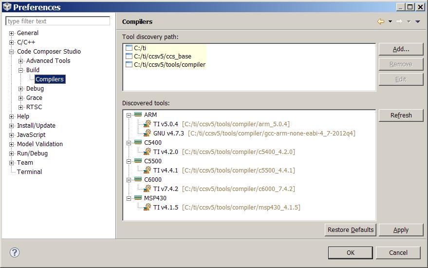

    I went to Window->Preferences->Code Composer Studio->BUild->code generation tools.  I don't see a way to obtain a compiler using this method.  All I see for MSP430 is the 4.1.5:
    I don't see a way to obtain new compilers to add in the Preferences dialog, so I tried the Install dialog again.

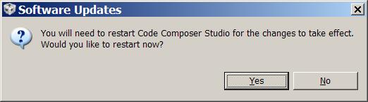

    I noticed the installation files appeared in the file system, then CCS prompted me to restart:

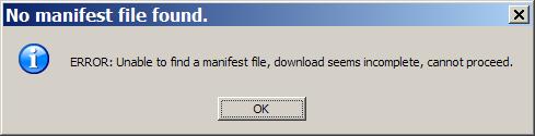

    After the restart, CCS gave this error message and did not run the install:

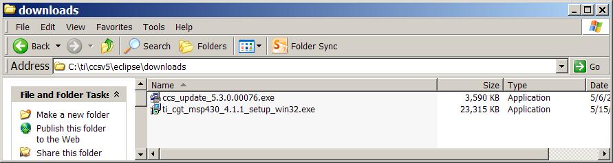

    Every time I try to start CCS, I get the same error as above.  I could only get CCS to restart after manually deleting everything from the C:\ti\ccsv5\eclipse\downloads folder.

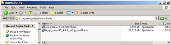

    If I can get far enough to collect the CGT installers that appear in C:\ti\ccsv5\eclipse\downloads , then I can complete the process manually.  For my current project, I need 4.1.1, 4.1.2, and 4.1.3, so I'll try this manual process for a workaround.

  • Actually, the installer that appeared in C:\ti\ccsv5\eclipse\downloads\ti_cgt_msp430_4.1.1_setup_win32.exe is corrupt.
    When I try launching this installer, I get the error:
    So it looks like I can't install using a manual process either.  Can someone from TI describe a working method to install 4.1.1, 4.1.2, and 4.1.3 in a fresh installation of CCS 5.4 that already has 4.1.5?

    ok, understood.  Before I send you anything please select the add button and add a path to the other compilers from you other isntallations and try that.   Windows->preferences->code composer studio->build->code generation tools has an add button ...
    Please let us know how that goes.  If that does not pick up other versions (I can verify I have 4 compiler versions installed by this method) contact me offline and I will help ... however note if you have these versions on your pc already my sending you them will only do the same thing ... add them to your pc.  You can contact me offline via a friend or conversation request.
