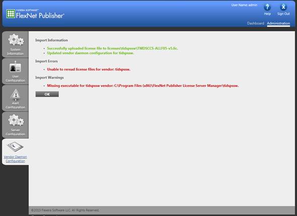

I've install CCS Floating server on windows 7.
And I got error. I attached error picture.
message is :
Unable to reread license files for vendor: tidspssw.
What do I need to check?
Thank you.
Jay.

    a couple things (with little information to go on here) that I can suggest as a start
    - I see a reference to program files ... this directory has odd windows permissions and we don't usually advise using it
    - did you follow the instructions here and do you have the vendor daemon and manifest file in the same directory as the flexnet server?
    http://processors.wiki.ti.com/index.php/License_Server_Administration_for_CCS
    Any further information would help.

  • Hi Lisa.
    There are some mistaken as you told.
    1.  Vendor daemon and manifest file is not in the same directory as the flexnet server.
         - Actually tidspssw folder was there and i guess they unzip under the name of folder. ( C:program../flexnet.../tidspssw/ vendor daemon and manifest file.)
    2. Windows permissions also cause problem. - change the folder permission related to the flexnet folder.
    And it is working fine.
    I really appriciate your support.
    Best regards.
    Jay.
