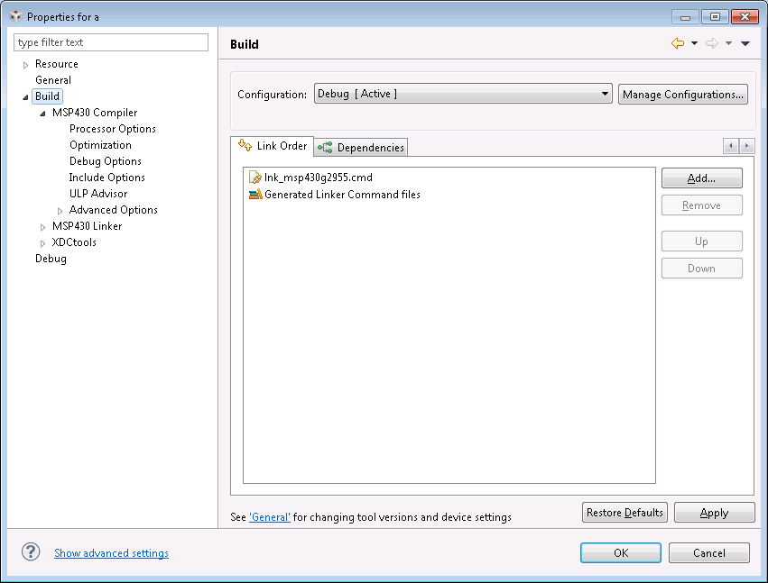

  • The first section specification wins, so the generated .cmd file is winning.  I don't know how to get your linker.cmd file to be linked first.  I thought that there was a way to control the .cmd file order, but I can't figure it out.

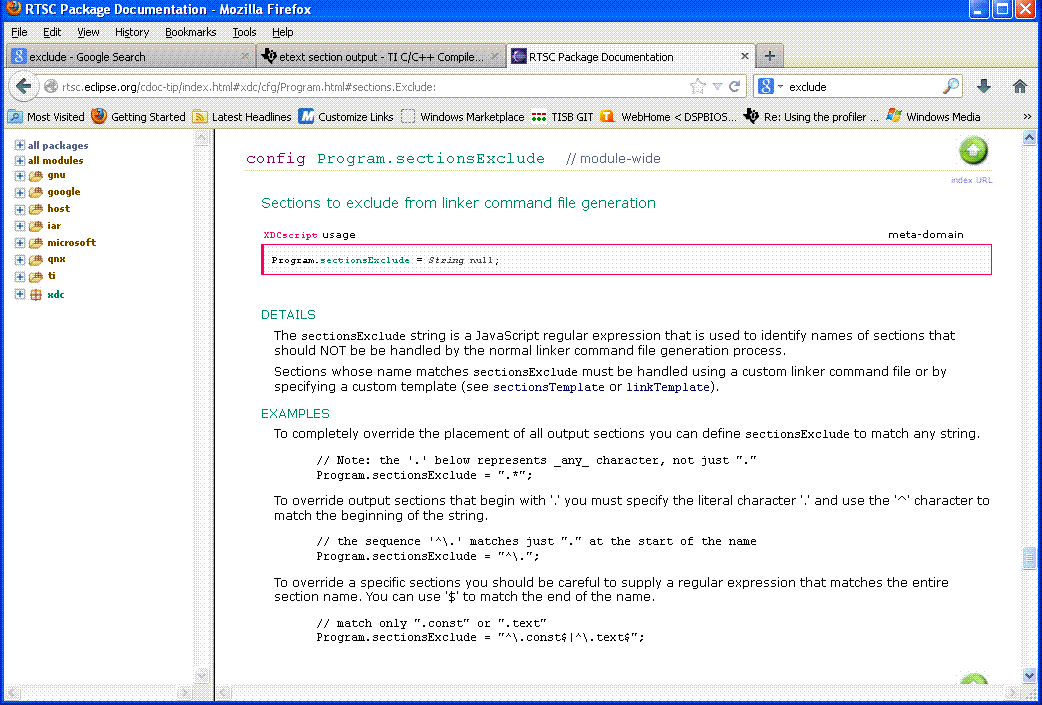

    I found another solution.  It is possible to exclude sections from the generated .cmd file with something like this.   I tried it and it worked.  See attached .zip file and docs below.
    4276.exclude.zip
    Program.sectionsExclude = "^\.text$";

    You can rearrange the link-order through the project's Properties > Build > Link Order tab:
