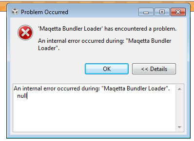

GUIComposer: 'Maqetta Bundler Loader' has encountered a problem
Other Parts Discussed in Thread: CCSTUDIO
I started today the first time the GUIComposer. I'm using CCSv5.4.0.00091 on a Win7 64bit machine. Any Idea why I have this error message?
Kind regards
Matt
  • Hi Matt,
    It could be that one of the required plugin is missing or you have a proxy setting that prevents the browser from communicating with the server. Can you attach the workspace log file here?
    Patrick

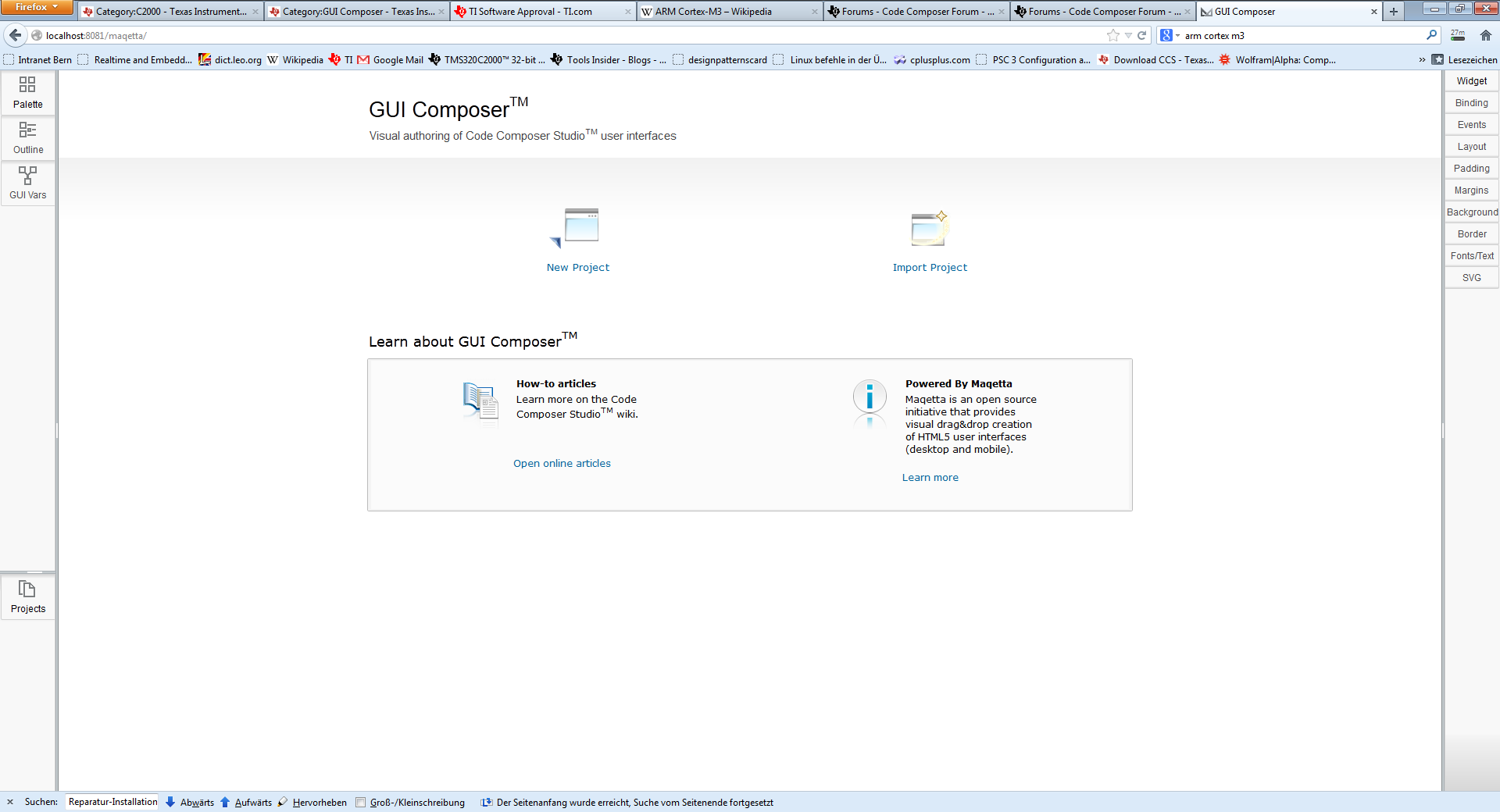

  • Having the GUI Composer tab open inside CCS, can you open up an external browser and enter this url, http://localhost:8081/maqetta/. See whether GC Designer comes up or not? This will at least tell us know whether it is a server issue or a browser issue.
    Patrick
  • Looks much better:
    What do you propose to do? As I unterstand I could also work with GUIComposer direct in Browser.
  • Not all functions are usable in the external browser, you can certainly use it to do most of your design work. I just want to see whether it is a browser issue or not.

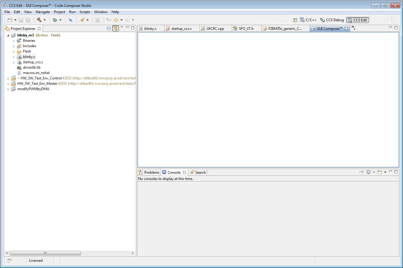

  • Patrick,
    1. Open the GC Designer once in CCS to startup the server, then close it and open it again to see if it is a timing issue or not?
    I've done the following steps:
    1. Open ccstudio.exe
    2. In Perspective CCS Edit, start View-> GUIComposer
    3. Wait, only blank Tab is visible in CCS. To check server, open in Firefox http://localhost:8081/maqetta/. In Firefox GUIComposer is visible.
    4. Close blank GUIComposer tab in CCS.
    5. In Perspective CCS Edit, start View-> GUIComposer
    6. Wait, only blank Tab is visible in CCS.
    2. Switch to use a different browser, edit ccstudio.ini and add -DTIBrowserType=mozilla. Restart CCS and see if GC Designer works or not?
    After edit the ini-file I restarted the CCStudio. Now the GUIComposer can be started inside the CCStudio. Is this now the workaround? Can I use GUIComposer in this way without any restrictions?

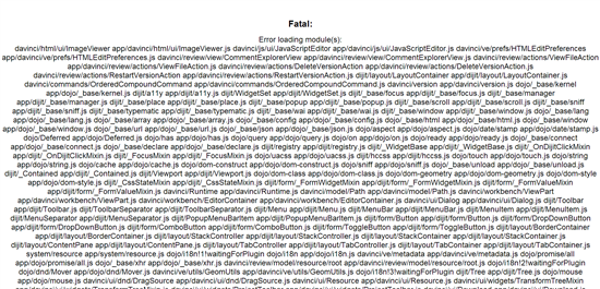

  • Hi Matt,
    To follow up with the default (chrome) browser issue, can you do a small experiment and see if this solve your issue regarding the browser not displaying anything? It should take a couple minutes of your time.
    Can you open this file, <install dir>\ccsv5\eclipse\plugins\maqetta.core.client_1.0.0.<buildid>\WebContent\pagedesigner.html. Uncomment the line require.on('error', moduleLoaderErrorHandler), line 143. And remove the mozilla browser property in ccstudio.ini.
    See if you can open up GUI Composer with the default browser.
    Thank you very much!
    Patrick
  • Hi Patrick,
    I tried the way you told me.
    Result: When I start GuiComposer it take some time and after that the text below appears in the GuiComposer tab. The text changes continously it seems that the program is doing a loop.
    Same result I have after closing and restart GuiComposer and after closing and restarting CCS.
    Another try was to create a new workspace this gives the same result. This idea I had because I used normally my old workspace from the former CCSv5.2 installation. Before I installed CCSv5.4 I removed the CCSv5.2 this was necessary because updating didn't work.
