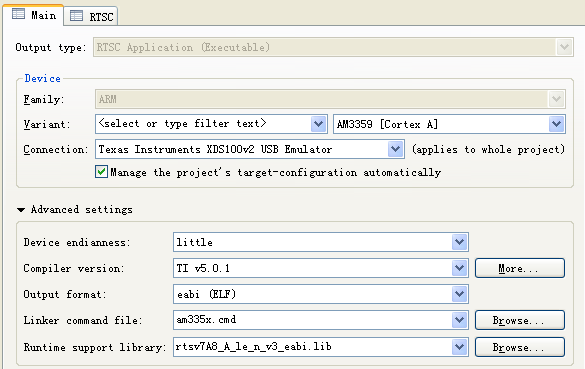

    Here is my project view

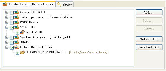

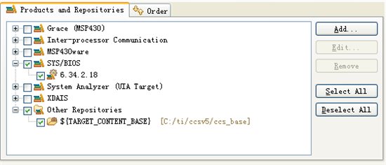

    The RTSC version:
    The compiler version and device:
    When I rebuild the uartecho project, This is the whole information I get from console:
