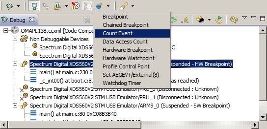

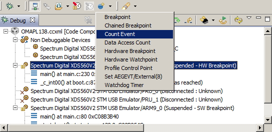

but when C674x core is selected, no option can be found in UBM for “state sequencing”.

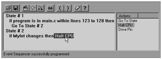

However as SPRA387 documented, “State Sequencer” is available in CCS versions as earlier as probably 2.0.  Is it hidden somewhere else in the menu in CCS 5.3, or CCS 5.3 doesn’t support it?
