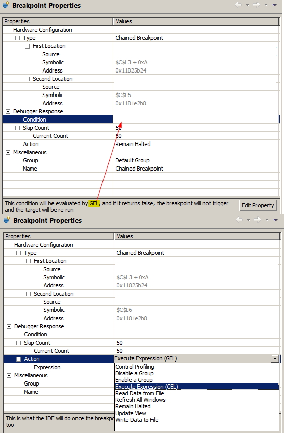

How to use GEL in UBM?
In UBM (Unified Breakpoint Manager) both Condition and Action are required to be in GEL format.
However I searched and read many documents:
  1. In CCS help, there is very little content on using UBM except articles like Modifying Breakpoint Properties.
  2. In TI.com or E2E.TI.com, there is also virtually no information on how GEL in these places should be set
Could someone provide examples on their use?

  • Hi Paul,
    You can specify a GEL expression for both the Condition and Action.
    Condition: Execute action (i.e. Halt) if a condition is met
    Action: Perform some action.
    Example 1:
    Say you which to set a breakpoint which halts the target at a specific location ONLY if a variable (int var;) on the target is a specific value (10). Then in the condition field, you can enter:
    var==10
    And leave the action field to its default "Remain Halted"
    Example 2:
    Say you which to set a breakpoint which will enable the profile clock at a specific location ONLY if a variable (int var;) on the target is a specific value (10). Then in the condition field, you can enter:
    var==10
    And in the action field you can choose to execute a GEL Expression (Execute Expression (GEL)) and enter the following GEL function call:
    GEL_EnableClock();
    Hope this helps

  • Paul Singh said:
    I wonder if you set a variable in GEL, how does UBM resolve its scope?
    For the example I used above, it would use whatever "var" is in scope of when the program is halted at that breakpoint/watchpoint location to evaluate the GEL expression. If the condition is not met it will then re-run.
    Paul Singh said:
    Therefore I wonder if you ever set a GEL like this, does it mean that
    (1) Hardware comparator do the major comparison (PC, data bus, either single or range), and halts the CPU each time when there is a match
    (2) whenever the CPU halts it is in a specific context, and GEL then resolves the variable ("var==10") in the specific range. GEL also retrieves the variable value via JTAG's boundary scan chain which is internally connected to different parts within the processor/SoC, rather than loading any instruction that would disrupt the instruction (and data) pipeline
    For #1, it applies to watchpoints and hardware breakpoints. Software breakpoints work differently - as you know.
    For #2, Yes.
    Paul Singh said:
    I guess the actions performed by GEL must be different: it would not load any instruction to the CPU to execute the action, but instead performs via the JTAG boundary scan chain so that it could effectively read/write/programs any registers. Is this the way it does
    Pretty much. It will access the target via JTAG read/write... just like the debugger would to display the contents of a variable in the Expressions view.
