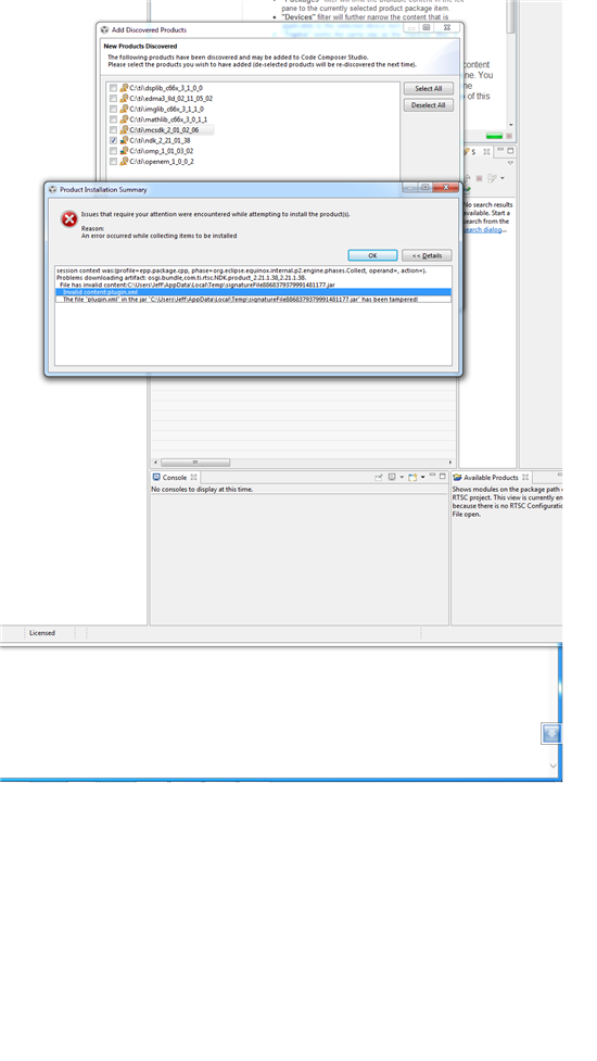

When I uninstalled CCS 5.3.0, it had difficulties ( An error dialog box popped up, something was wrong etc.). I had to uninstall each component one by one. In the end, I forced to delete all the folders under c:\ti. I install CCS v5.4. Then, I install MCSDK. When I run CCS v5.4, it detects the new MCSDK components, but with errors. It seems the register is messy up. How can I do to make it work?

  • Hi Everyone,
    the best thing would be to post your installation/update logs.  These are in the installjammer registry directory ( a likely hidden folder in program files or program files(x86)).
    Some tips
    - try to run all locally (ie no use of servers/junctions/mapped drives).   Although the installer is improving its handiing of these situations, I would not recommend them
    - make sure antivirus is off and you have full permissions
    Lisa
