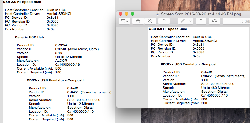

  • I have somewhat good news. I am able to reproduce a working Parallels / XDS200 setup. As mentioned in my earlier post, it starts working when i connect the XDS200 via a 4-port USB hub. I have included pictures of this hub below. Unfortunately i don't have much info about it, it's quite old. I could break it open if someone needs to know the specific make & model.
    I am also including some screenshots of the device manager and OS X USB enumeration with and without the hub. With the hub is on the left, without on the right. On the windows side, the only thing that changes is the com port of the XDS. could that be it? Otherwise, i am not sure why it's working with the hub.
    If anyone has any ideas based of this info, please let me know, would love to get this working without the hub.
  • Only and probably the critical difference is that your hub is old and is a USB 1.x hub. It is running at legacy 12 Mbit/sec speeds and if forcing the XDS200 to also act as a USB 1.0 speed. It may be hard to find old enough hubs that fall back to 1.0. I will try to get Parallels to use USB 1.0 but I'm not sure it will work.
