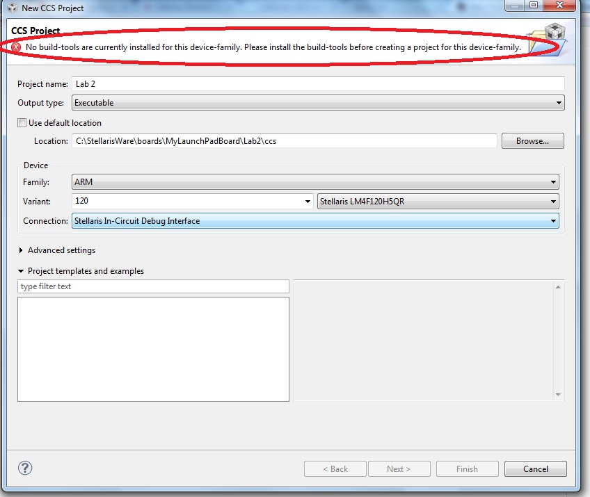

In Lab 2 when it prompts me to create a new CSS project. I get this error:
All of the other fields are filled in exactly as they are in the workshop manual.

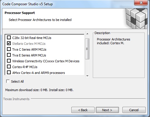

    when you installed ccs did you install stellaris/tiva support?   It seems like ccs can not find the arm compiler.  This could be due to
    -installation options (fix - rerun the installer to the same directory and select repair to add)
    - antivirus or permissions problems

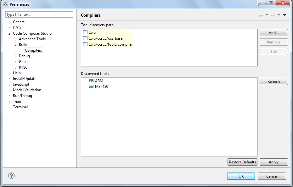

    What do you see in window->preferences->code composer studio->build->compilers?

  • In answer to you first question, If I understand it correctly, yes I did install Stellaris support.
    and here is what the screen you asked looks like:
    Edit: I seem to have scrolled down a bit I also have this part checked:
    as for antivirus problems, I am working on a laptop provided by my employer. He is out of town at the moment so if that is the problem I'd like to consult with him before changing anything.

    Is there any further details you might be able to provide?  One thing that is a little odd if that you have no versions for the compilers listed.  Do you see the same issue with an msp430 project?  If so .. the suspicion would be the compilers are not present/are being blocked.  Have you verified permissions?

  • Disabling the antivirus during install worked.  It wasn't allowing the installer to access its own files.
