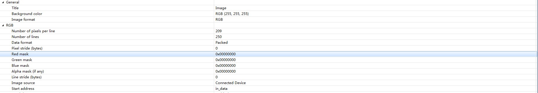

I have used matlab to transfer a bmp image into a data file and assign them in an array in CCS.
Then in the debug mode, I select tools-image analyzer. But I  do not know how to set it to show the image. (just as the picture shows)
Could anyone help me.Thanks for your attention for this matter.

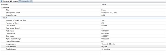

    The correct parameters greatly vary depending on the image itself. In the past I helped someone display a greyscale image at this thread.
    I hope this helps,
    Rafael
  • Thanks for your reply.
    The value of my image is "250*209,24 bits,bmp". As you suggested in that post, I set the value as below:

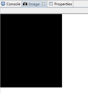

    But the showing  image is always black:
  • BTW, I first use a matlab program as below to convert the file into a data file:

    Then in CCS ,I assign the elements to an array named in_data like this:
    unsigned char in_data[52250]={0x39, 0x2e, 0xa0, 0x3e, 0x1e, ....................}
