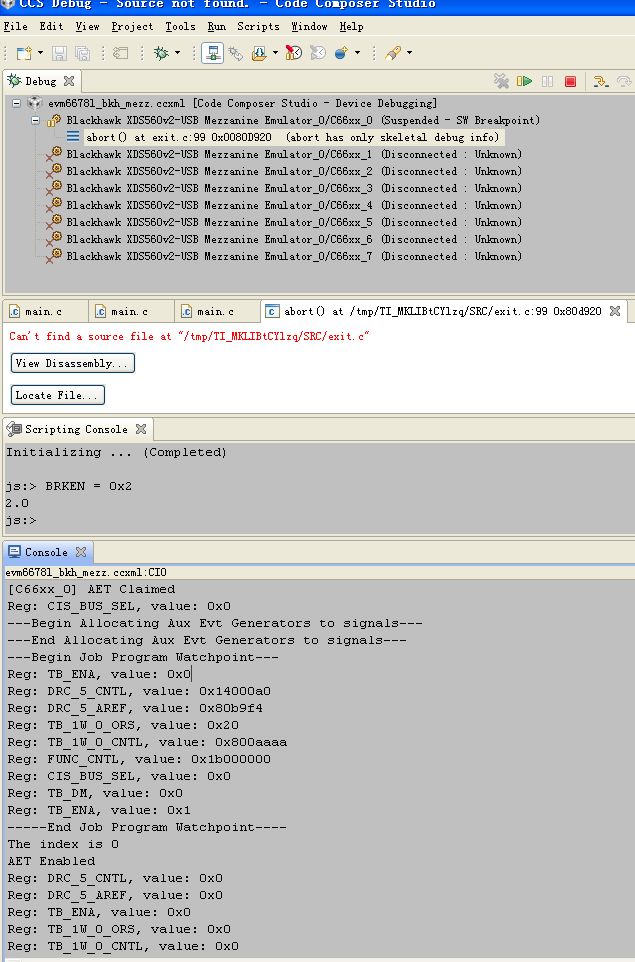

I  can't  get the cpu halted,    when i dowload the halt_on_watchpoint.out to the target -tms320c6678  using the ccs5.3.0 -spectrum digital xds560v2 emulator.
AETLib_4.1 --examples -- halt_on_watchpoint
                      6678Release-halt_on_watchpoint.out
the program run to   abort();and can't see  the cpu halt ,
I also new a project for 6678,
set BRKEN = 0x2,
still can't work .
