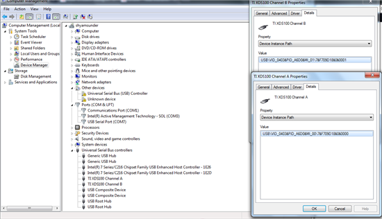

    i am using c5515 DSP,but i am not able to figure out what happened surprisingly the error has gone,now i am successfully able to debub......
    my computer has 2 front panel USB ports one is connected with the Emulator i am using .to other another USB ,a another device (not emulator)which is doing some other work,after removing that USB device and connecting it to back panel resolved the problem
    is this a coincidence or what,the situation repeated again when i re connected the USB to the 2nd port

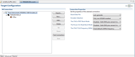

    If the other device uses the same FTDI device as in your c5515 DSP emulator, maybe CCS tries and communicates with the other USB device instead of the emulator.
    With the 2nd USB device plugged in:
    1) Does the test option on the target configuration still work?
    2) Does changing the the target configuration to select the emulator by serial number then allow the debugger to work?
    Selection by serial number is supposed to allow more than one emulator to be used - but if there is a conflict with a 2nd USB device maybe selecting by serial number will help - see http://processors.wiki.ti.com/index.php/Multi-Emulator_Debug_with_CCSv5
    yes all the tests have succedded
    ok now the problem is  i have removed the other usb so its clear that the problem is not because of any device connected this is just a coincidence but there is some other problem here is  my snap shot of device manager,device details which you may find appropriate
