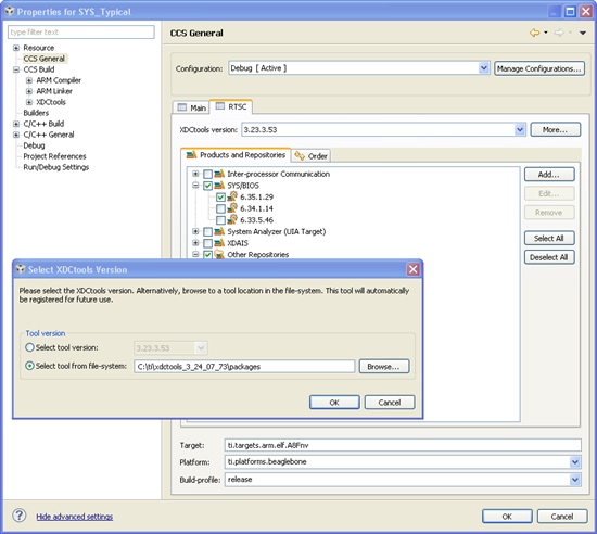

Automatic Product Discovery doesn't work in CCS5.2.1
Other Parts Discussed in Thread: SYSBIOS
I have installed the xdctools_3_24_07_73 to the default location C:/ti, but CCS doesn't recognize the package automatically. I also tried to add the repository manually via the preferences.
but I can't select the tool version in the project property page.
Any idea what's wromg here ? Klaus

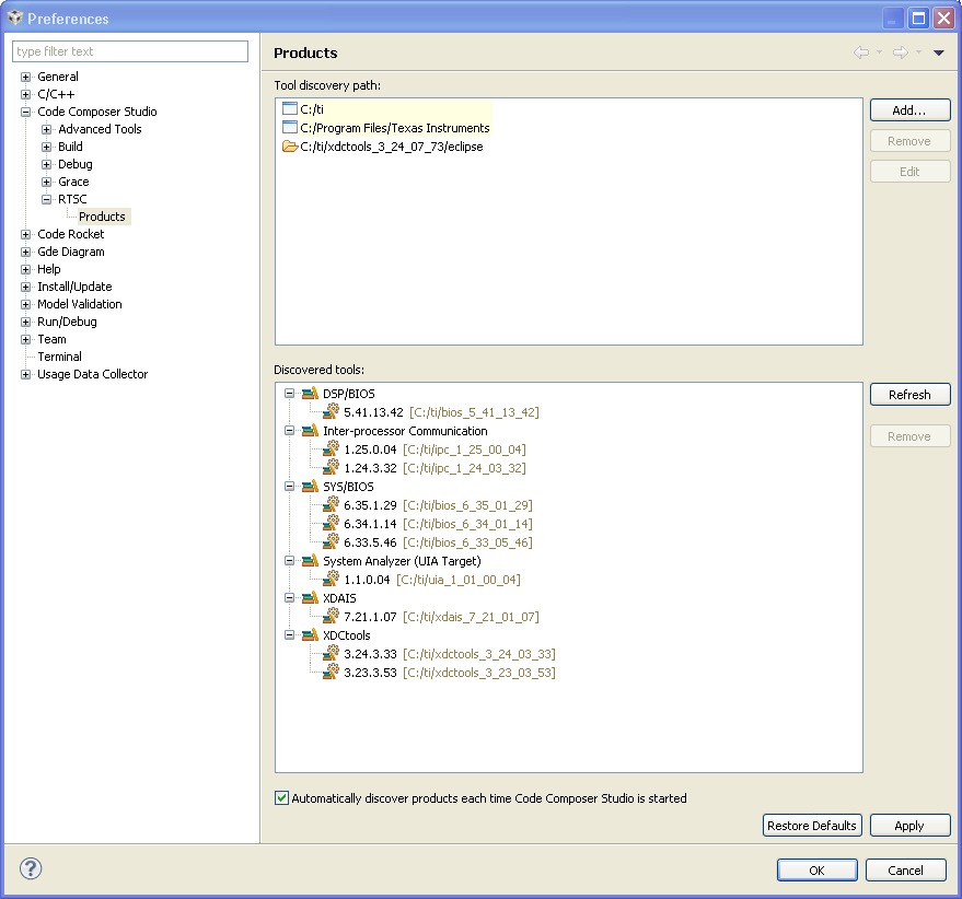

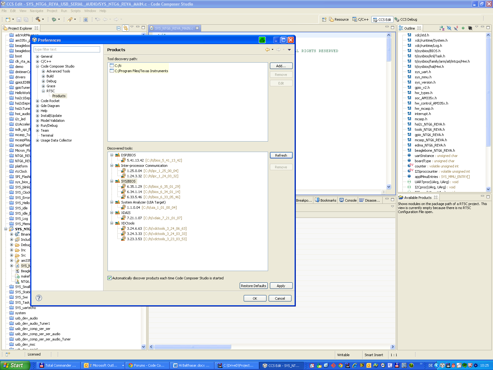

  • Hi Lisa,
    as can be seen below, the latest XDC package and two of the SYS/BIOS packages are not recognized by CCS although they are in the same installation path as tzhe others and correctly includes in the search path....
    Klaus

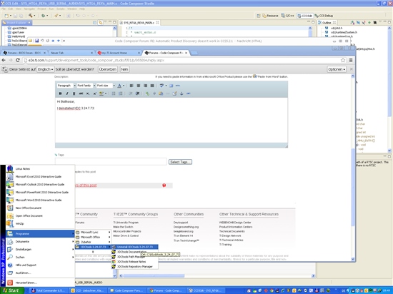

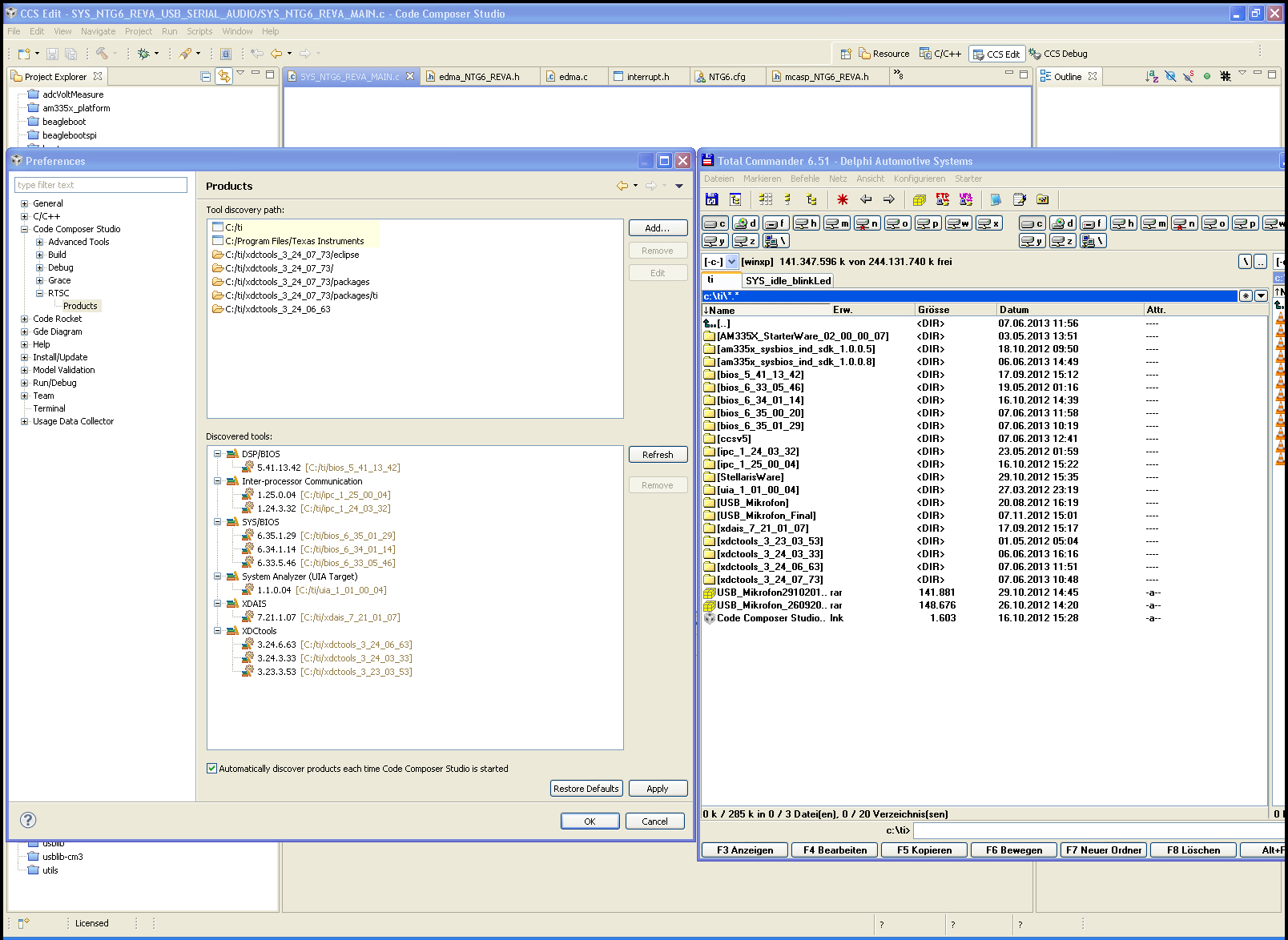

  • Hi Balthasar,
    I did:

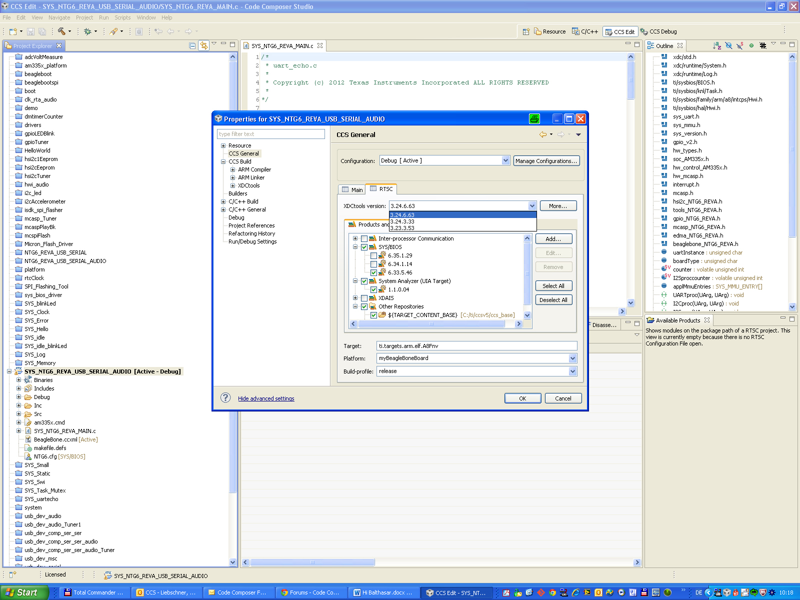

    1.) check the available XDC Tool versions in my project's property setup. 3.24.7.73 is NOT available, but included in the ccs.properties file!!
    2.) deinstall XDC 3.24.7.73:
    3.) Restart CCS

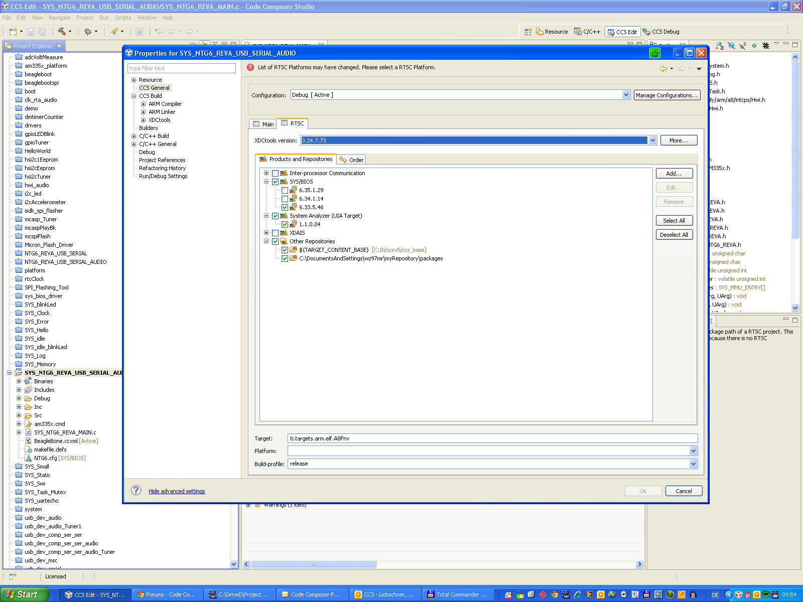

    4.) Checked the available XDC Tools versions in my project's property setup:
    Suddenly the version 3.24.7.73 is selectable, but not available. CCS says: "List of RTSC Platforms may have changed. Please select a RTSC Platform"
    5.) closed CCS
    6.) reinstalled XDC 3.24.7.73
    7.) restarted CCS and checked XDC tools version in my project properties: XDC3.24.7.73 is NOT available:
    8.) closed CCS
    9.) edited ccs.properties file (removed C\:/ti/xdctools_3_24_07_73/eclipse;C\:/ti/xdctools_3_24_07_73/; from the tools discovery path)
    10.) restarted CCS
    11.) Tried to refresh the Tools discovery:
    NO SUCCESS!!!!!!!!!!!!!!!!!!
    Conclution: There is a significant problem within the automatical TOOLS DISCOVERY in CCS!

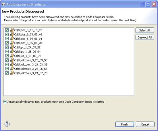

  • Hello Baltasar (nice name by the way),
    after I came to the point, that I cannot proceed with the newest XDC package, I have installed CCS5.4 additionally in an other path. At the first start the CCS5.4 could recognize all packages in the C:\ti installation path...
  • missing pictures:
    and the packages are available in the project:
    So the issue was a problem of CCS5.2.1.
