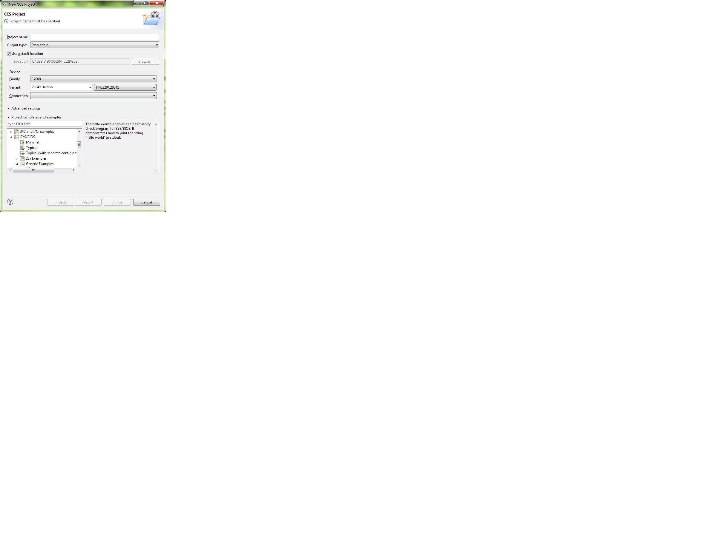

    the new project wizard has build in bios examples.
    Are you able to build and run one of those without issue?
    See the screen capture ... I could not expand it far enough but you could for example try the hello example under generic examples.
    Lisa
  • for device TMS320F28335 I selected SYS/BIOS->SYS/BIOS->28x examples->Swi Example
    This built and generated a *.out file.
