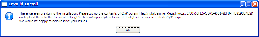

Hi Champ,
I got a "Invalid Install" dialog below, and attach "InstallJammer registry" to this post.
Could you please check it out?

It looks like some process, like TrendMicro anti-virus, prevented the unzipping of one of the components.
Can you check to see if the file xdctools_3_24_06_63_base_windows.zip or xdctools_3_24_06_63_base_windows.zip.bk exists in the eclipse/downloads folder? If it does, extract it to c:\ti to complete your update.
