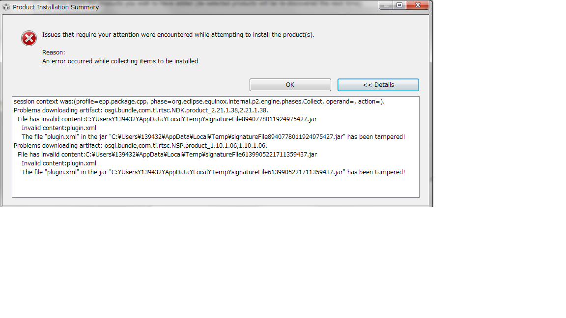

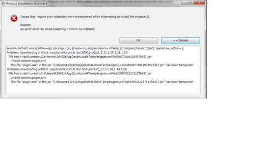

  • Hi Danish,
    I tried my scheme. CCSv5.4 itself looks working. Thank you.

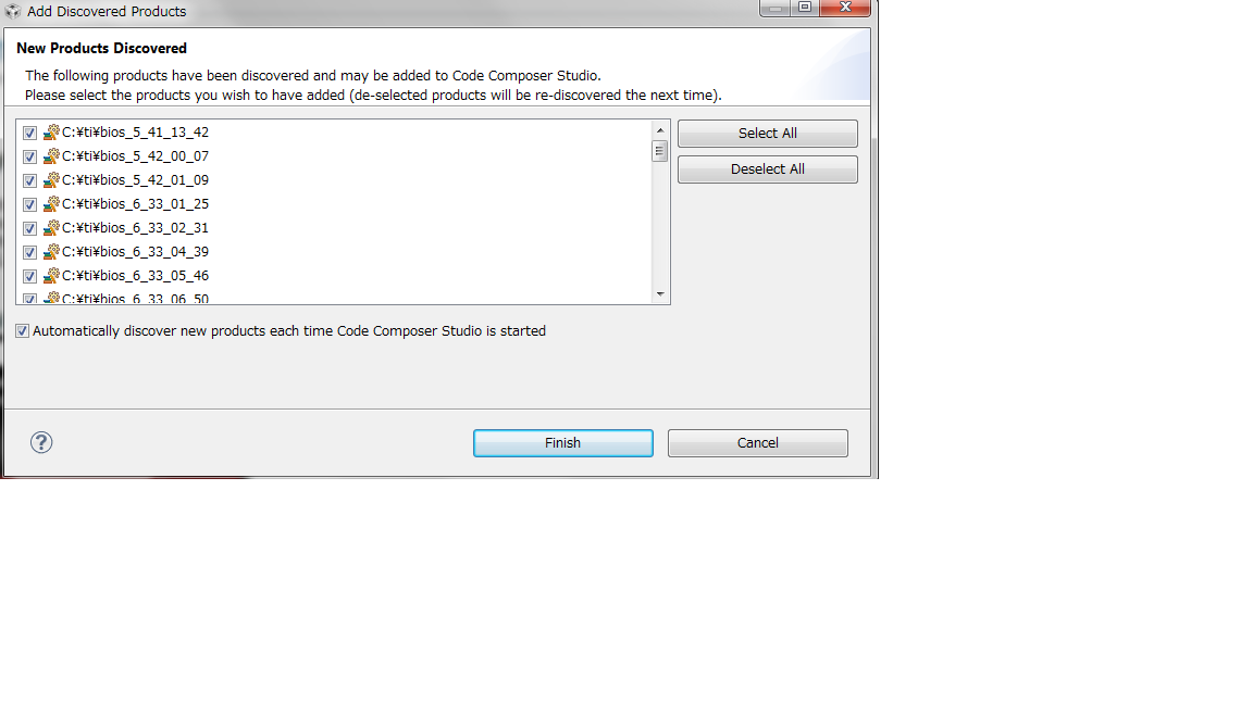

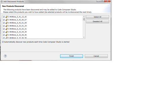

    But I saw an error during the auto-detection of RTSC packages on C:\ti.
    The following wizard is up when I launch CCSv5.4:
    When I pushed "Finish" button and then CCSv5.4 started to recognize the RTSC packages, but lastly, I saw the following error:
    This looks like failing the detection of RTSC packages...
    I seem my scheme described in above can't work correctly.
    In conclusion, it may be better to follow Danish's way.
