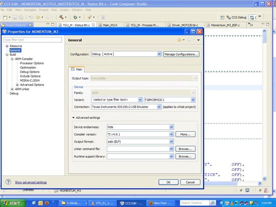

Buildfile generation error occurred..
I am new to this forum and for CCS. I Installed the ccs and imported the existing project. When i tried to build, Im getting the build error as given below
This project was created using a version of compiler that is not currently installed: 4.9.1 [ARM]. Please install the compiler of this version, or migrate the project to one of the available compiler versions by adjusting project properties.
Build stopped..
It is developed for chip F28M35x. Please let me how to resolve this
  • Hi Shivashankar,
    you can normally ignore this warning.   Alternatively you can install the older compiler version and use that for your project.  Are you able to debug?   Do you have C2000 support installed?
