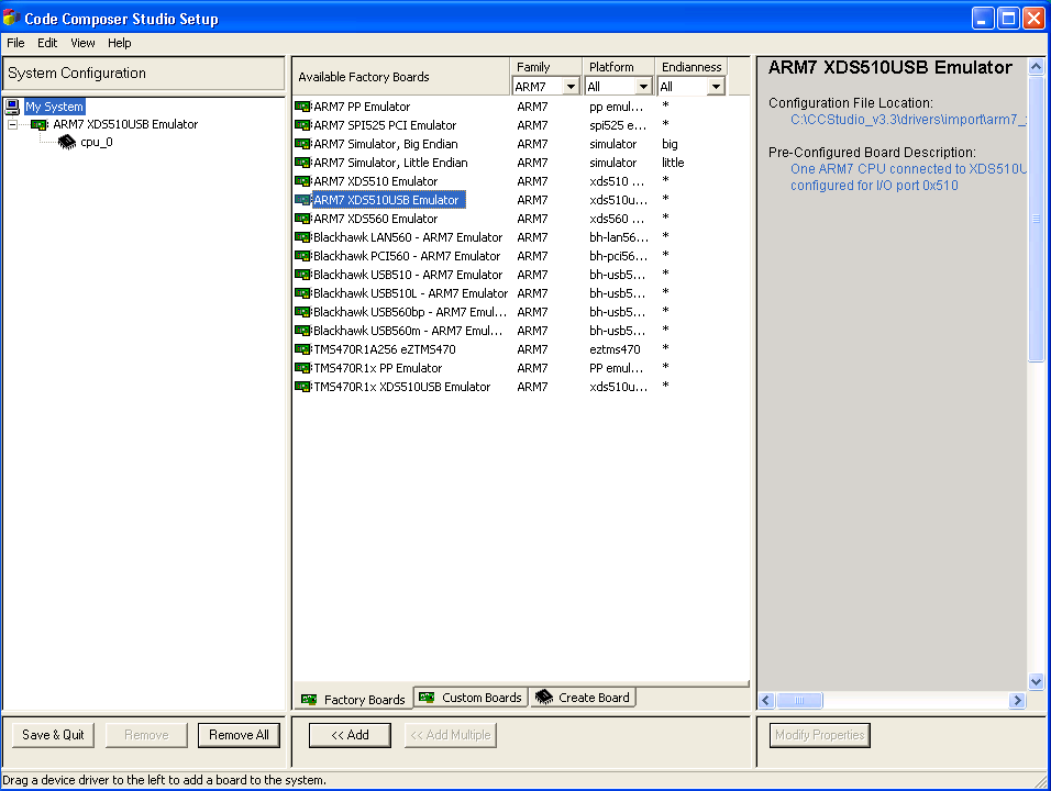

I have been trying to load my code(CCS3.3) which is for a resoant llc converter to the control card(UCD3138), but I have failed. Although the code is running well, I can not see the PWM signals on the output. I am using USB interface adaptor(USB to I/O), and here is my configuration: ARM7TDMI simulator, Big Endian
Can you please provide me with a simple project to test  my board (UCD3138) and see if it is working correctly? I have access to both CCs3.3 and CCS5.
    I am not sure if the board already has code pre-loaded (thus it is running fine) or if you are actually have a different CCS configuration, but one thing I am 100% sure: CCS simulators run entirely on the PC and never connect to a board.
    In this case, can you double-check what is the exact emulator (XDS510, XDS560, etc.) you have and properly configure CCS to connect to it? Unfortunately I am not very familiar with the UCD family of controllers and therefore I am unsure of its connection details, but my best guess is to select it as shown in the attached screen.
    I also found a flash programmer for this family of devices on the product page (check here) - maybe that is the only way to program the target board.
