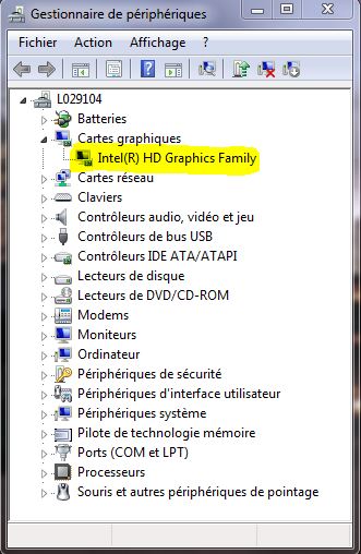

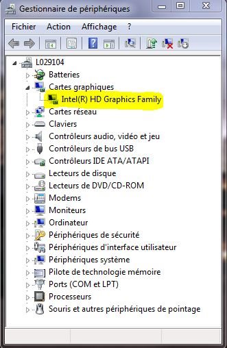

  • Hi Bruno,
    Can you tell me what video card you have on your PC? If it is nvida, do you have the latest driver on your PC?
    Patrick
  • Hi Patrick
    I have no video card on my laptop except the embedded GPU on the Core i7
    So I think the correct answer is : no Nvidia, Intel based video Card (see capture)
