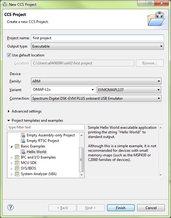

I am  using OMAP L137 with ARM9 and DSP. I want to know which family and variant should I choose when I create a new project.
Thanks!
Zhe
  • Hi Zhe,
    Project->New ccs project
    Family:  ARM
    Variant : omap L1x
    Please give that a try and keep us informed.
    Lisa

  • Hi Zhe,
    if you want to learn more I suggest the omap forum.    Normally yes, you would connect the board using an onboard or external emulator and write and debug code.  Starting with an example is always the best.  But if you have hardware connection and getting started question with your hardware, I would say the omap forum is a better place for those kinds of questions.
    Lisa

  • Hi Zhe,
    if you are able to debug you are connected to your board.
    The configuration is done in the target configuration file which will be a ccxml file associated with your project.
    Lisa
  • Hi Lisa,
    Which connection should I choose in the .ccxml file?
    Thank you!
    Zhe
  • HI Zhe,
    this depends on the emulator you have.  You need to select the appropriate emulator.  There are various emulators that are compatible with the L138.
    Lisa

    what hardware do you have?  Are you using a specific evm?  If so which one?  If not what emulator do you use?
    In the ccxml you select according to the hardware you have.  There are many different emulators ... xds100, xds510, xds560, on board cards etc.  You need to select the one you have but I do not know what hardware you have.
    Lisa

  • Hi Zhe,
    I would recommend following these links:
    http://processors.wiki.ti.com/index.php/Getting_Started_Guide_for_OMAP-L137
    For the ccxml, if you have an evm, try a simple first example setting it up as in my screen capture.
    Lisa
