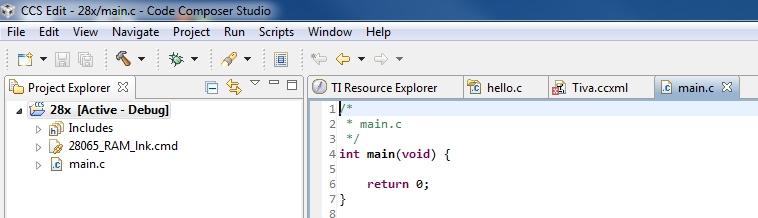

    Are you talking about the case where it will stop highlighting the active project in the project explorer?  i.e. in the first capture below it has the context but in the second it does not.
    In this particular case the active project is not highlighted in the second capture as the source file I have selected is not part of any project I have open.

    If this is the problem then it would definitely cause issues with the active project selection as well.  If I have main.c which is part of my project open and I click on the tab for hello.c which is not part of that project then I will lose the active project selection.

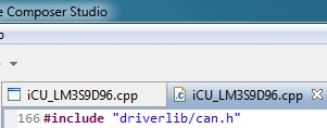

    But yes the file and it's mirror file seems to be located different places. Could it be related to virtual paths somehow then?
    The two files have different icons as well:
    BR, Carsten
  • Can you show the full paths in the tooltip?  i.e. the paths where CCS thinks each file is located.  What do you mean by virtual paths?
    As far as the icons the one on the left means it is not associated with a project, is that the one that was opened by CCS when debugging (i.e. the second one that was opened)
    John

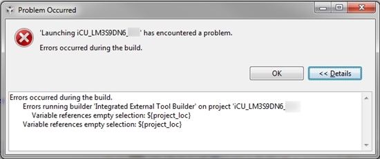

    BTW the error I get since CCS looses focus on the active project is this:
    BR, Carsten

  • Hello Carsten,
    My apologies for delayed response. Dobrin is the expert on source search path issues.
    Regarding the error that you are seeing. ${project_loc} macro is dynamically populated based on currently selected project in project explorer. If there is no active selection in project explorer (i.e. there is no project that has bold font), then that macro is not valid. Most likely that is not what you want. I would suggest that you use PROJECT_LOC instead, the case does matter or PROJECT_ROOT. This is a project static macro that should not change based on selection. Maybe project_loc is also introducing some issues with building that maybe are confusing source search paths.
