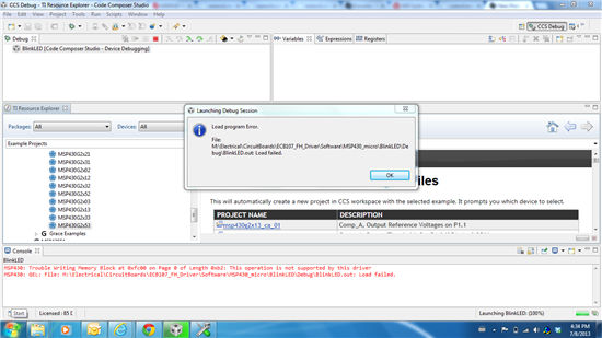

I created the example project of blinking the LED, which I just verified works with IAR. Here is the error I get when I click debug:

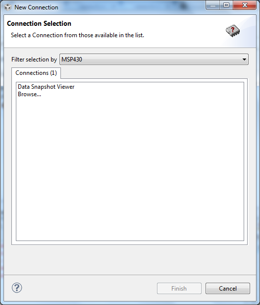

There isn't a default .ccxml file, but when I create one, the only option it gives me as a debugger is "Data Snapshot Viewer".

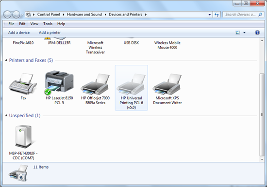

Here is the MSP-FET as it shows up in my devices:

    The "Data Snapshot Viewer" connection shouldn't be the only one in the list... Do you know if this installation of CCS worked before?
    The reason of my question is because it seems you are missing several files in this install... Check the directory below and see if you find several XML files or just <DataSnapshotDecoder*.xml> there?
    <CCS_INSTALL_DIR>/ccsv5/ccs_base/common/targetdb/drivers
    This will surely indicate a problem with the installation (something went wrong or simply no emulator support was selected) or a possible HD corruption (where windows erased the existing files).

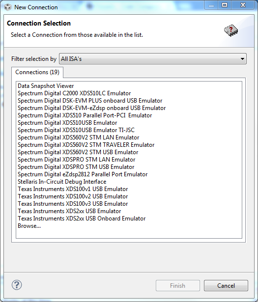

  • It's only when I filter by MSP430 that all of the other options go away. When I select "All ISA's" a lot of different options show up.
    and all of those files do show up in the drivers directory. Am I missing some?
  • When you install CCS you can select what features you want (C2000, MSP430, Sitara, C6000 etc). It looks like you have installed C2000 only.
