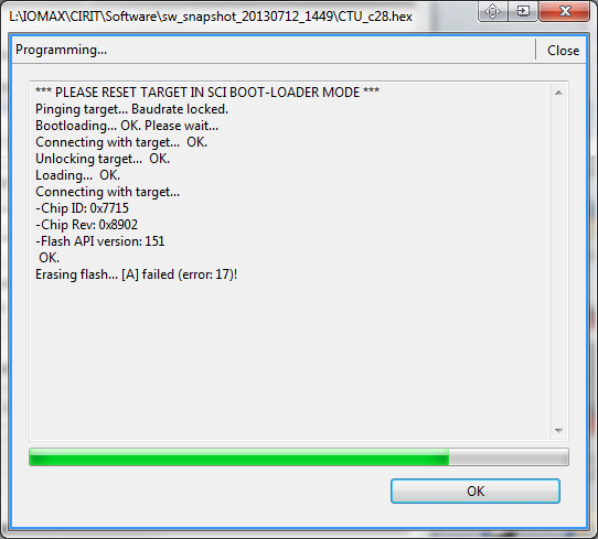

    I ran CodeSkin C2Prog and managed to program the M3 core with out a problem but failed to program the C28 as it came up with an error when it tried to erase the flash, see attached image.
    I did note that the Chip ID, Chip Rev and Flash API are the same as those reported on chips I can successfully program.
    Nigel
  • I was mistaken the chip rev is different, the ones I can successful load have a chip rev of 8900, the failure occurs on chip rev 8902

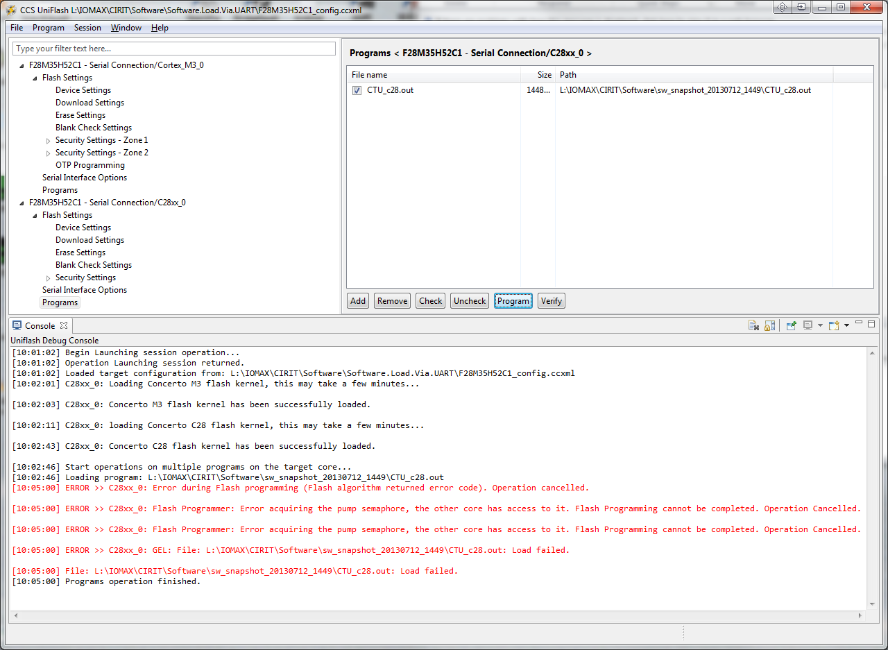

    I applied the patch and can now program the M3 core. However I get the following error when trying to program the C28 Core:
    [10:17:32] ERROR >> C28xx_0: Flash Programmer: Error acquiring the pump semaphore, the other core has access to it. Flash Programming cannot be completed. Operation Cancelled.

    I spoke to soon. I have one file that will load, all other files I attempt to load come up with the semaphore error. Here is the error I'm getting:

    [08:55:21] ERROR >> C28xx_0: Error during Flash programming (Flash algorithm returned error code). Operation cancelled.
    [08:55:21] ERROR >> C28xx_0: Error Writing Flash @ Address 0x00100000 of Length 0x00003FF8
    [08:55:21] C28xx_0: Writing buffered data @ Address 0x0010AA28 of Length 0x00000004
    [08:55:21] ERROR >> C28xx_0: Flash Programmer: Error acquiring the pump semaphore, the other core has access to it. Flash Programming cannot be completed. Operation Cancelled.
    [08:55:21] ERROR >> C28xx_0: GEL: File: L:\IOMAX\CIRIT\Software\sw_snapshot_20130715_1613\CTU_c28.out: Load failed.
    [08:55:21] File: L:\IOMAX\CIRIT\Software\sw_snapshot_20130715_1613\CTU_c28.out: Load failed.
    [08:55:22] Operation Writing flash memory returned.
    Nigel
