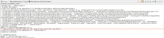

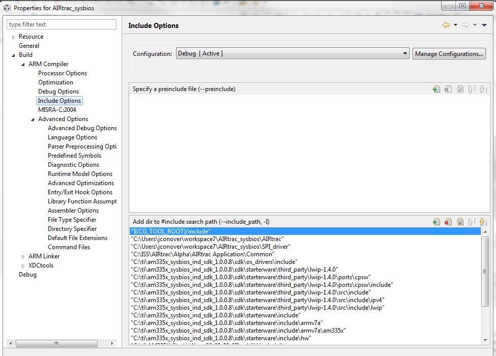

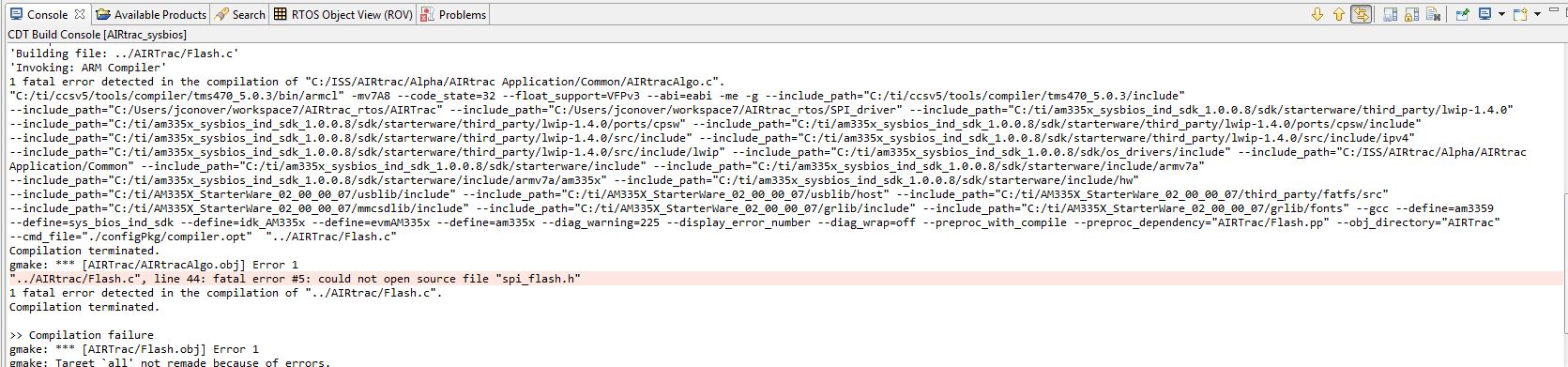

     For both of these files the Console tab shows that during the build, a couple of the include_paths is incorrect even though the path is set correctly in the Project compiler properties. The project was renamed from "AIRtrac_rtos" to "AIRtrac_sysbios". As you can see from the captures below the Console is showing the the include path to be:
--include_path="C:/Users/jxxx/workspace7/AIRtrac_rtos/AIRTrac"
When it should be:
"C:\Users\jxxx\workspace7\AIRtrac_sysbios\AIRtrac"
     I have tried everything I can think of but the same two files (out of 40 or so) continue to have this issue. Any help is appreciated.

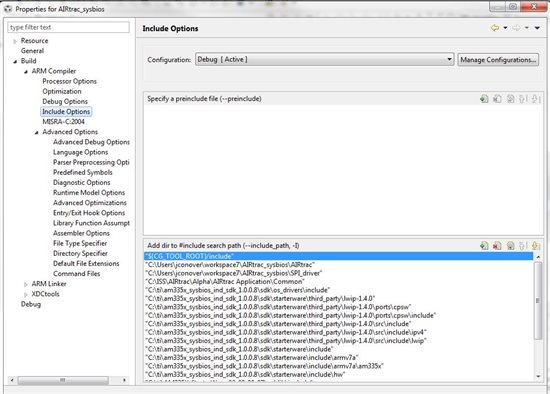

    did you also check the File search path under the ARM Linker options?   Did you try a clean and / or reindexing before build?
    Lisa
  • Hi Lisa,
                  I've tried the following with no luck:
    • Project Clean rebuild
    • Project Index--> Rebuild
    • File Index-->Freshen All Files
    • File Resource Config--> Reset to Default
    • ARM Linker --> File Search Paths (the incorrect path is only needed for compiling.)
    Any other suggestions?
         John C.

             In poking around the .mk files I found the AIRtrac_sysbios/Debug/AIRtrac/subdir_rules.mk file to have the old directory name used in the include path. I modified this file to use the correct path as was able to get the project to build. The file says I'm not supposed to edit it so could you tell me how to get Code Composer to rebuild it?
         John C.

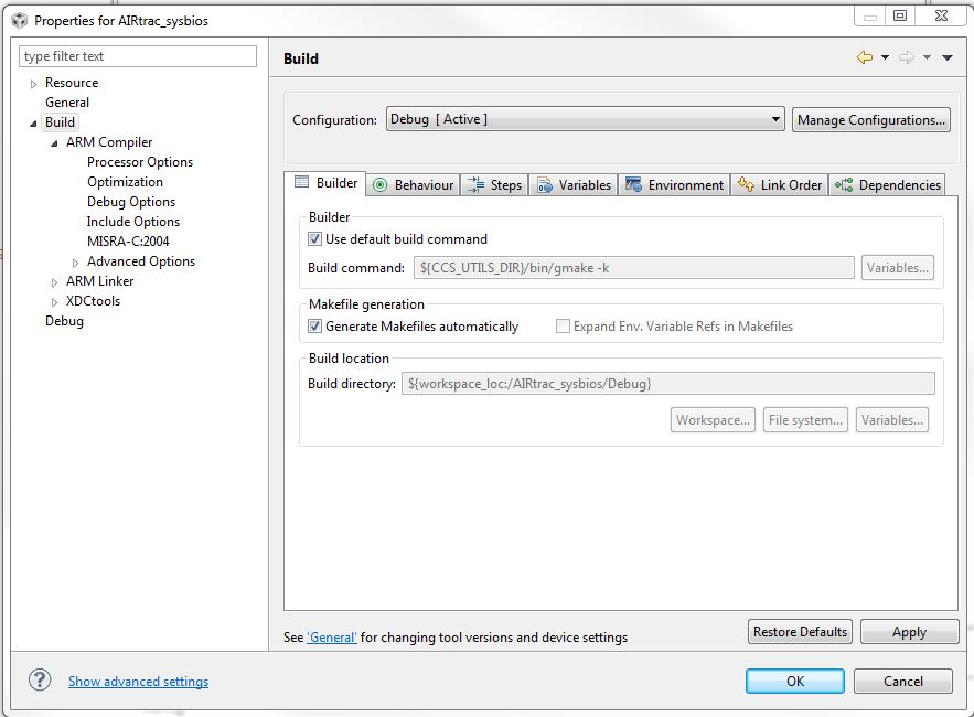

    ok, you should not have to manually modify the make file if the project settings have been changed or you have rebuilt the project.   I am trying to determine if this is a bug/see if I can reproduce this here.  But first can we please check one option that might be causing this behaviour?
    What is your makefile setting compared to this wiki
    http://processors.wiki.ti.com/index.php/Projects_and_Build_Handbook_for_CCS#Changing_the_make_utility
    Do you have cdt managed make disabled?
    Lisa
  • Hi Lisa,
                   Here is the snip of my main build settings:
    John C.
  • Hi John,
    would you be able to try reproducing this in a non source control environment?  I have been struggling to try to reproduce this here with no luck.  I have tried multiple projects with multiple types of include paths and variables and non are breaking for me when I rename them.

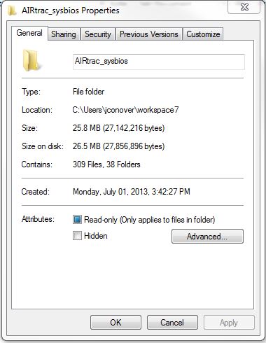

                    Yes the project is currently out of version control (SourceSafe). I check the top level directory (the project driectory) and it seems to have have a read only attribute:
               I unchecked this attributed, saved it to the directory and all files under the directory and now the build has no "access" problems. The truly bizarre thing is that if I bring up the same directory again, it still has the read only flag on.
    John C.
  • Hi John,
    I looked in my user/workspace directory.   I found the same "read only" however ... still have no issues renaming projects in those workspaces.   I get no breaks, no access denied.  So still can not reproduce this ... and seem to have the same file settings.
