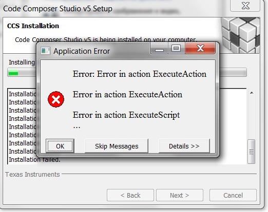

Installation error CCS v5.4.0
the installation crashes with the following error on my system:
Installation log:
2251.ccs_setup_5.4.0.00091_install.log
The system configuration:

Firewall is off, antivirus is off.
It was made:
As a workaround, could you go into NVidia Control Panel/3D Settings/Manage 3D settings, then for the "Base profile" Global presets, set Preferred graphics processor drop-down to "High-performance NVIDIA processor". It was set on "Auto-select".
