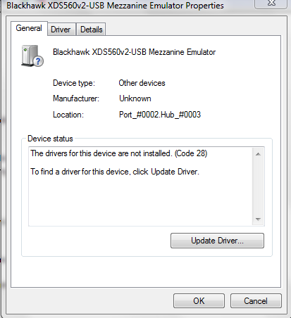

  • Thanks for the information.  I am running natively.  I would like to try to reinstall the driver(s)  Can you point me to the right driver/reference for uninstalling/reinstalling.  I want to confirm that I am reinstalling the appropriate driver(s) and the appropriate software.

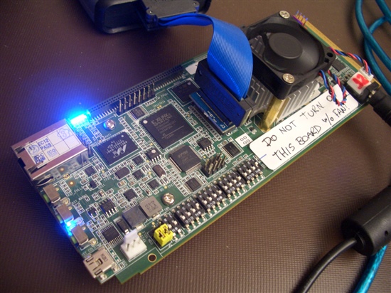

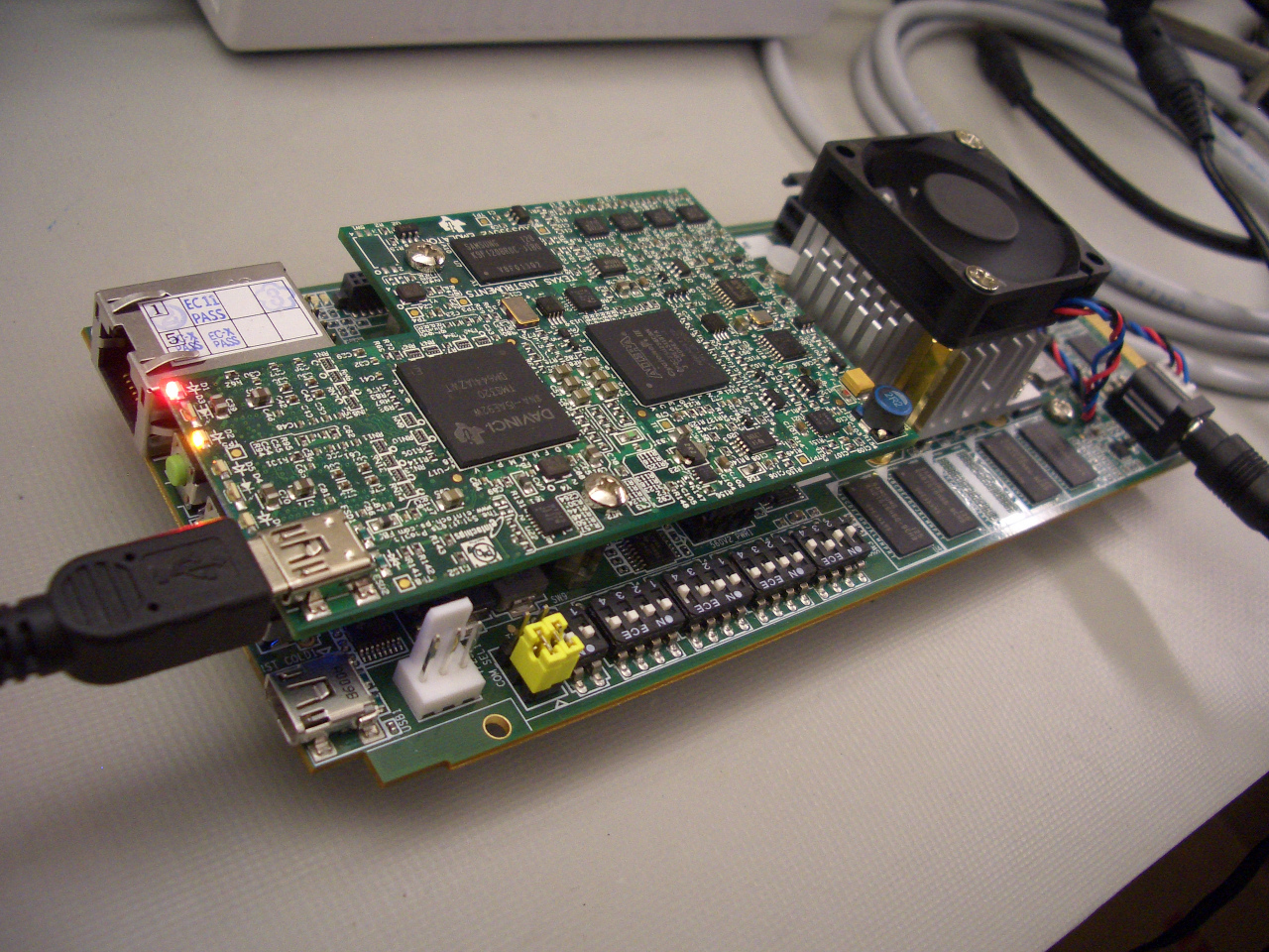

  • Elana,
    I just want to clarify a few things: when you say you are connecting a XDS560v2 emulator to your TMDSEVM6678LE you mean using the board on top of the main EVM board (also called Mezzanine) or an external XDS560v2 emulator? In other words, are you doing this:
    Or this:
    Also, regarding the BH utility: that is what I see when I run mine here when I am using the Mezzanine (disregard the LAN emulators).
    The Windows device drivers for the emulator are typically installed by Blackhawk and the default placement is:
    C:\Program Files (x86)\Blackhawk\Emulation\Drivers\Bh560v2\v1.0.0.7
    The base device drivers don't change much across the years, and since you see a properly initialized entry in the Control Panel I am really not sure if this is the issue...
    I did another test: I just removed the Mezzanine board and the CCS connection to the XDS100v1 emulator on the base board succeeded without problems.
    This comparison indicates there is something going bad on the board. Do you think you could try to get a different 12V power supply and retry connecting to the board? I've seen this before (sometimes the output voltage is lower, or there is too much noise and the devices do not get properly initialized).
    At last, if you can get a similar OutputLog as shown in the Bh560v2 config utility above, can you copy it to a .txt file and attach to your post? I can compare the settings with mine and ask for some help from Blackhawk.
    Rafael
  • Thank you for posting the photos.  You solved the problem.  The documentation said to use usb:1.  Moving the usb cable to usb:0 (as shown in your photo) solves the problem.
