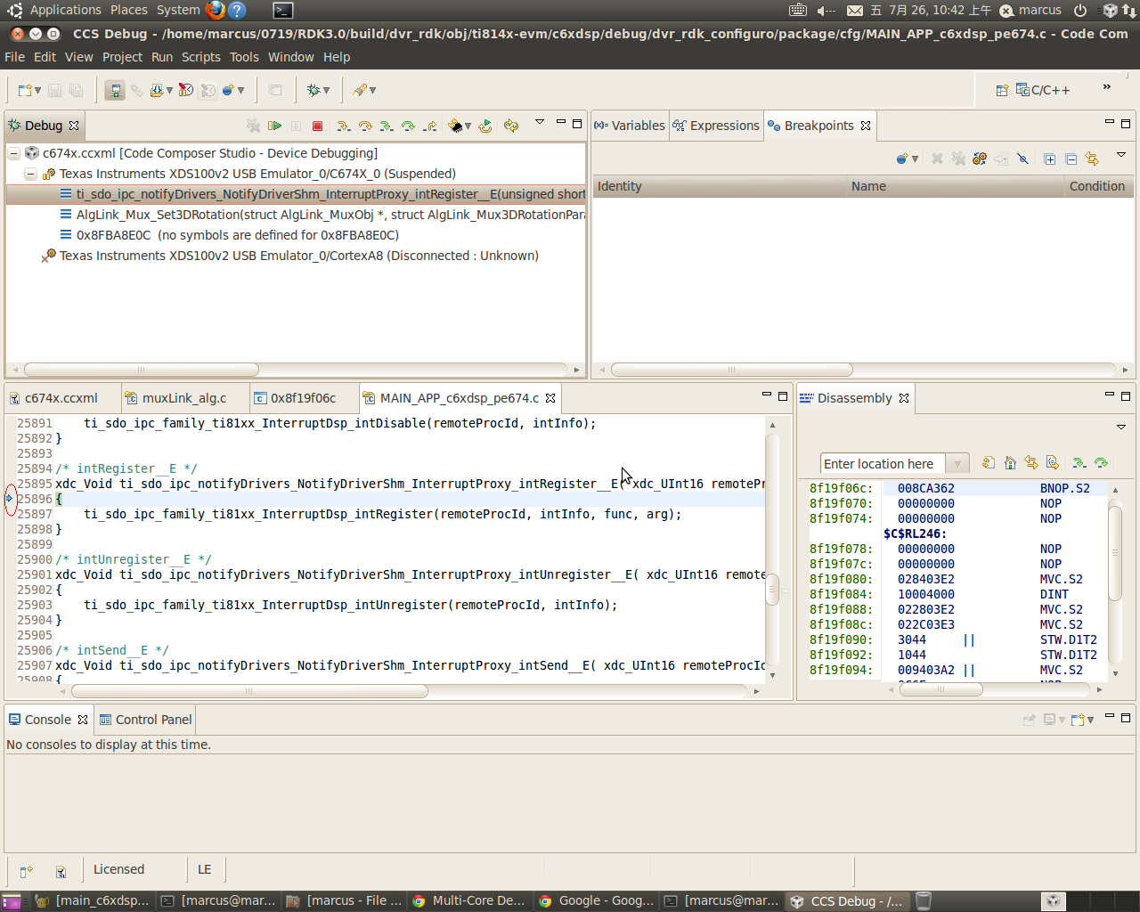

  • Hi Ki :
    Thanks for your reply!
    When I load the symbols, it seems I can start debug because there is a break point appear on the screen.
    The picture below can show the situation and break point is in red circle.(I am not sure if it is break point)
    You can see that after I load the symbol "dvr_rdk_fw_c6xdsp.xe674", I can use step into, that's why I think it is a break point.
    However, when I press F8 "Resume" to run DSP, I can not debug anymore.
    Could you tell me if what I done is correct?
    And I will post this issue on DM8148 forum.
    Marcus
    That is NOT a breakpoint. It is a blue arrow indicating the location of the program counter (where you are halted in your code)
    After you loaded the symbols, the target is halted and CCS will show you where you are halted in your source code with that blue arrow.
    If the target is running, you will not have any debug visibility. You'll need to halt the target again. What happens when you halt?
