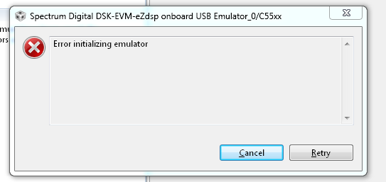

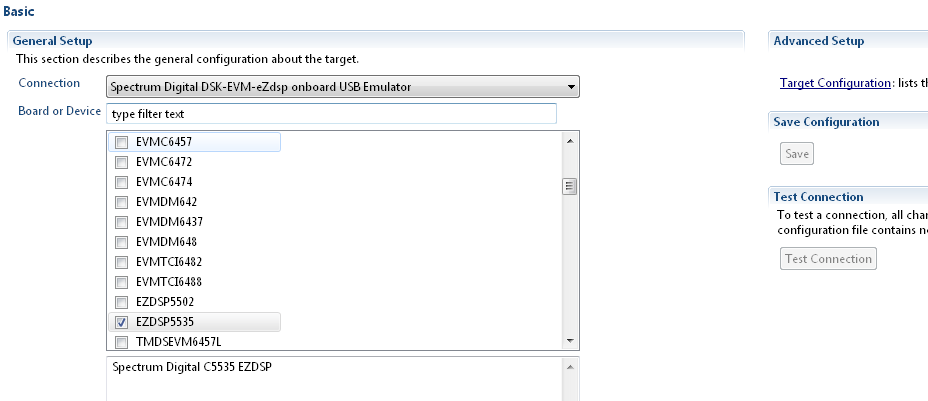

    When I try to use ezDSP XDS100 emulator, I select a C55 target, see below image:
    but it cannot debug, shown

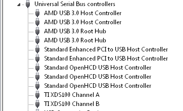

    XDS100 driver is installed now (use J2 USB port), see picture:
    but it still shows "Error initializing emulator" as previous post shows. What is wrong now?
  • Robert,
    You are using the wrong connection type. You should be using the one for XDS100v2, not the Spectrum on-board USB emulation (this option applies to onboard XDS510 emulation).
    ki
  • It is TI XDS100,  not SD product. solved.
