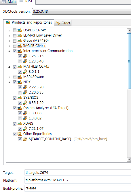

Hi , I'm using OMAPL137 evm board with XDS510USB emulator.
I need to use RTA agent, but once I turn on RTA agent, I got following linker error.
'Invoking: C6000 Linker' "C:/ti/ccsv5/tools/compiler/c6000_7.4.2/bin/cl6x" -mv6740 --abi=coffabi -O2 --define=c6747 --display_error_number --diag_warning=225 --diag_wrap=off -z --stack_size=0x800 -m"audio137.map" --heap_size=0x800 -i"C:/ti/ccsv5/tools/compiler/c6000_7.4.2/lib" -i"C:/ti/ccsv5/tools/compiler/c6000_7.4.2/include" --reread_libs --warn_sections --display_error_number --diag_wrap=off --xml_link_info="audio137_linkInfo.xml" --rom_model -o "audio137.out" -l"./configPkg/linker.cmd"  "./process.obj" "./mcasp_TTO.obj" "./main.obj" "./led_TTO.obj" "./led.obj" "./isr.obj" "./coeffs.obj" "./coefficient.obj" "./aic3106_TTO.obj" -l"D:\dhkim2\PROJ\L137\work\bsl\evmomapl137_v1\dsp\lib\evmomapl137bsl.lib" -l"C:\ti\uia_1_03_00_02\packages\ti\uia\sysbios\lib\release\ti.uia.sysbios.a674" -l"rts6740.lib" <Linking>
undefined       first referenced                                                                                 symbol             in file                                                                                     ---------       ----------------                                                                                _TaskSelf       C:\ti\uia_1_03_01_08\packages\ti\uia\sysbios\lib\release\ti.uia.sysbios.a674<TransportNdk.o674>  _accept         C:\ti\uia_1_03_01_08\packages\ti\uia\sysbios\lib\release\ti.uia.sysbios.a674<TransportNdk.o674>  _bind           C:\ti\uia_1_03_01_08\packages\ti\uia\sysbios\lib\release\ti.uia.sysbios.a674<TransportNdk.o674>  _fdClose        C:\ti\uia_1_03_01_08\packages\ti\uia\sysbios\lib\release\ti.uia.sysbios.a674<TransportNdk.o674>  _fdCloseSession C:\ti\uia_1_03_01_08\packages\ti\uia\sysbios\lib\release\ti.uia.sysbios.a674<TransportNdk.o674>  _fdError        C:\ti\uia_1_03_01_08\packages\ti\uia\sysbios\lib\release\ti.uia.sysbios.a674<TransportNdk.o674>  _fdOpenSession  C:\ti\uia_1_03_01_08\packages\ti\uia\sysbios\lib\release\ti.uia.sysbios.a674<TransportNdk.o674>  _listen         C:\ti\uia_1_03_01_08\packages\ti\uia\sysbios\lib\release\ti.uia.sysbios.a674<TransportNdk.o674>  _recv           C:\ti\uia_1_03_01_08\packages\ti\uia\sysbios\lib\release\ti.uia.sysbios.a674<TransportNdk.o674>  _send           C:\ti\uia_1_03_01_08\packages\ti\uia\sysbios\lib\release\ti.uia.sysbios.a674<TransportNdk.o674>  _sendto         C:\ti\uia_1_03_01_08\packages\ti\uia\sysbios\lib\release\ti.uia.sysbios.a674<TransportNdk.o674>  _setsockopt     C:\ti\uia_1_03_01_08\packages\ti\uia\sysbios\lib\release\ti.uia.sysbios.a674<TransportNdk.o674>
>> Compilation failure  _socket         C:\ti\uia_1_03_01_08\packages\ti\uia\sysbios\lib\release\ti.uia.sysbios.a674<TransportNdk.o674>
error #10234-D: unresolved symbols remain error #10010: errors encountered during linking; "audio137.out" not built gmake: *** [audio137.out] Error 1 gmake: Target `all' not remade because of errors.

I update latest version of uia and ndk package, but i got same problem .
My library package is follow.
Thanks in advance.
