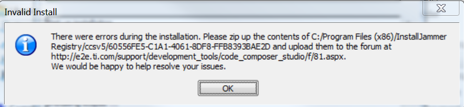

I am getting errors below when installing an offline installer of CCS v5.4.
I do not see the InstallJammerRegistry folder in my computer.
The "installjammer registry" folder is hidden, you need to "unhide" it.

Attached is the zip file from C:\Program Files (x86)\InstallJammer Registry\ccsv5\60556FE5-C1A1-4061-8DF8-FFB8393BAE2D.
Your problem is very simple to solve! Please unzip the offline installer on your hard drive before trying to run the installer. Also, make sure that you delete everything from the previously failed install directory before starting.
Please keep us informed as to your progress.
