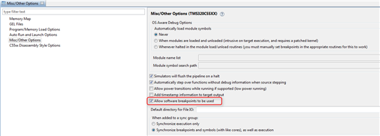

  • One other thought is there is an option that may have gotten turned off.  If that option is not checked then CCS will only set hardware breakpoints
  • I see both H/W BP and S/W BP.
  • It was already clicked.
