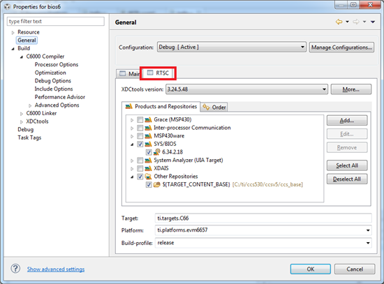

I've downloaded 3.24.06.63, and can see it installed in the correct folder location.  When I go into Control Panel -> Programs and Features, I can see XDCtools 3.24.06.63 listed so I know Windows installed it.  However, when I start CCSv5 it doesn't find the 3.24.06.63 (normally new SW is found at startup of CCSv5).  When I go to the Project -> Properties -> RTSC tab it only show 3.25.2.70 in the drop down.  Trying to manual install using the More... also failed.

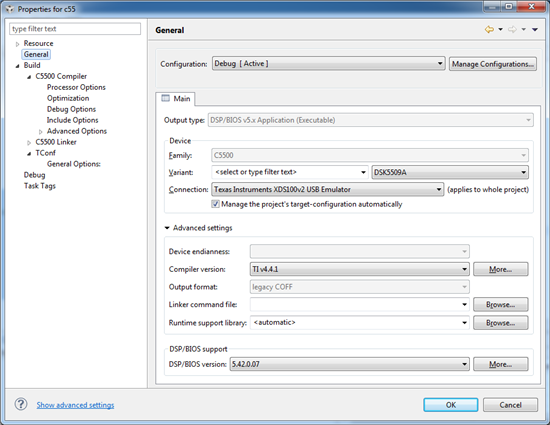

    For DSP/BIOS it should use the xdctools that are part of the DSP/BIOS installation automatically.  i.e. you shouldn't have to ( or even be able to)specify the tools.  If you look in the DSPBIOS_5_4x_xx_xx folder in CCS there should be an xdctools folder under it.
    For me I don't  even get an option to select the xdctools version when working with BIOS5.

    What does your RTSC tab look like?

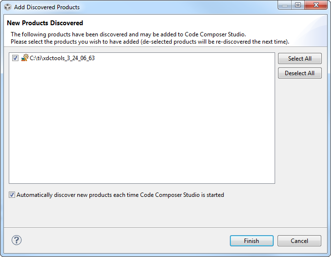

  • Ok I installed the same version as you: 3.24.06.63.  I installed it into c:\ti\xdctools_3_24_06_63
    When I started CCS it detected it automatically.

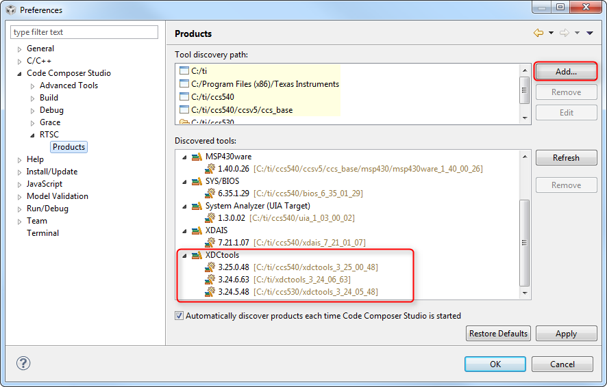

    If you installed in a different location you can tell CCS where it is by going to the Window->Preferences menu.  Select Code Composer Studio -> RTSC -> Products in the tree on the left.  You can add a search path at the top of the dialog, then restart CCS and then go back to that dialog and see if it is now listed on the bottom
  • Nope the "auto detect" isn't finding 3.24.6.63.  Furthermore, under the "Discovered tools" window, I don't even see the XDCtools tree.  I've installed 3.24.6.63 in the same folder as all other downloaded stuff, and it is the same folder that contains 3.25.x.x  Obviuosly I screwed something up when I uninstalled a bunch of stuff.  Some of the stuff I uninstalled via the Control Panel -> Programs and Features, some via the uninstall program that lived in the folder, and some by just deleting the folder.  Not everything uninstalls the same way.
