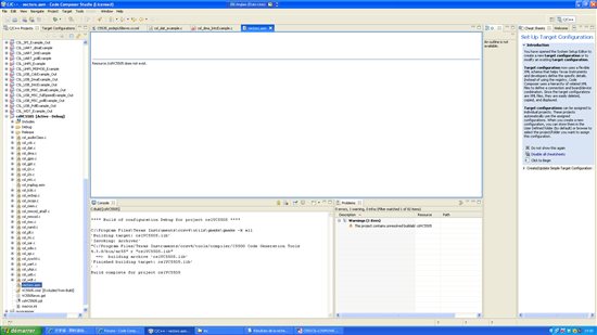

After I install CCS v4.2 bundled with eZdap 5535 USB board, I installed CSL 3.01 and modified csl_general.h (commented out 5517 etc.). I import all example projects once, but the all the projects show error signs. I try to build one project CSL_DMA_IntcExample, it depends on CSLVC 5505 (This is right for my 5535 USB?). I build csl vc5505 project, the library under debug folder has only 8 bytes.
I also find that when I click the two .asm files, it cannot open, see the above picture.

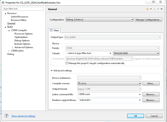

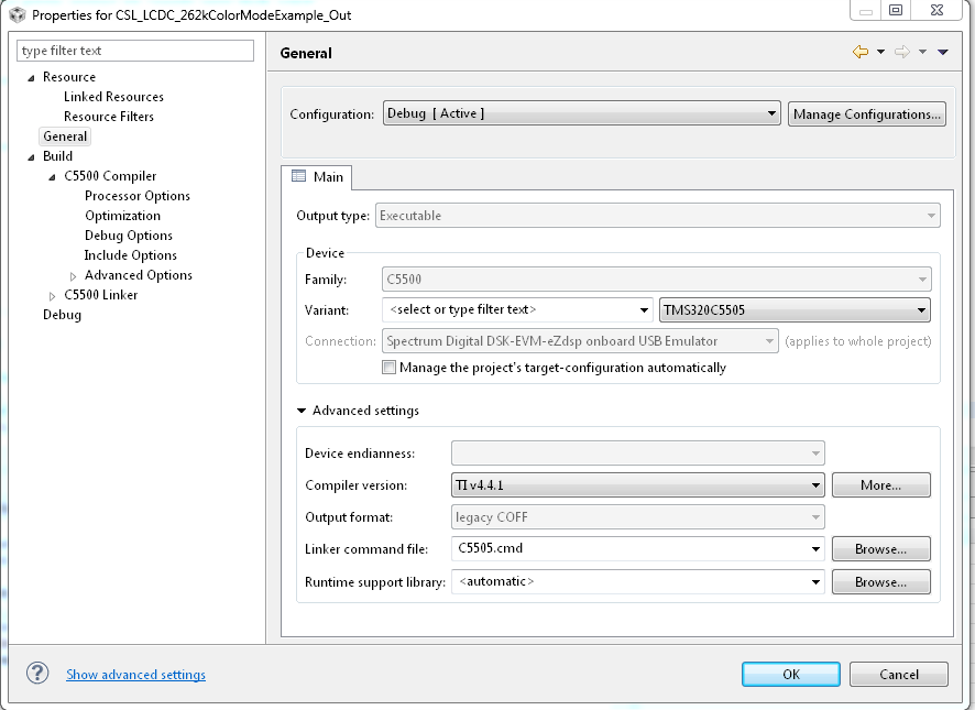

  • In the end, CCS v5.4 can work with CSL3.03. But, CCS v5.4 is still prone to generate error. First, one project CSL_LCDC_262k can compile. After I change its chip from TMS320C5505 to TMS320C5535, it cannot compiler anymore, even I change it back. I find that the build property menu changed (there is no effective compiler box, even I import it again)
    What can make the compiler effective box appear again?

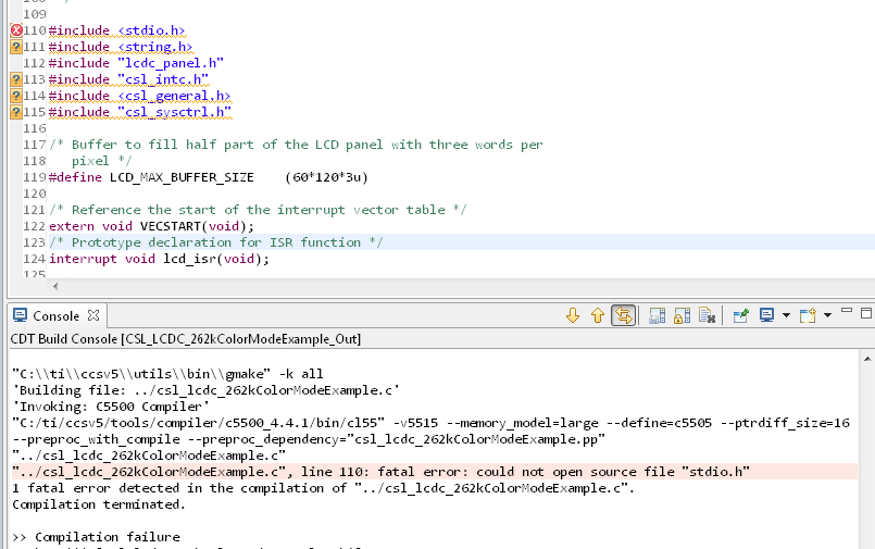

  • OK. I forgot to add the error. It does not find the header file path, such as:
    I am not sure how to set chip in compiler property for eZDSP5535. Leave it TMS320C5505 even for my new project? Or I can set it to 5535? Thanks,
