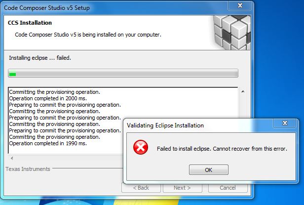

CCS 5.4 Install Error, InstallJammer attached
Win7 x64, fresh install, no nVidia. I've tried both the offline and web installer, no luck.

  • I've disabled as much as I could. There's some remains of McAfee lingering around that I haven't been able to get rid of, but I've disabled the Symantec Endpoint Protection that's installed. I don't have much control over that, although I haven't had issues with previous versions on other machines. I downloaded and tried both installers that are in the table (not the big button).
    I'll try to see if I can find someone else to login to this machine and attempt to install it.
    Anything else I should try in the meantime?
  • Another user and another computer, same thing.

    I have been running the logs and your case by a few colleagues now as well.  One of the only things we could find so far is if your posting is related to this:
    https://forums.oracle.com/thread/1239778 that suggests the user set JAVA_TOOL_OPTIONS to blank.
    Would you be able to try to do that while doing the install?
    08/05/2013 09:24:23AM - Watching progressive output for matches
    08/05/2013 09:26:37AM - ExternalProgramStatus 1
    08/05/2013 09:26:37AM - ExternalProgramResult Picked up JAVA_TOOL_OPTIONS: -Djava.vendor="Sun Microsystems Inc."
    Please keep us informed.
    Lisa
  • That did the trick. I removed that environment variable and everything installed as it should.
    Thank you for your prompt help!
