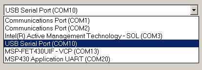

  • Error msg "Error trying to initialize emulator."
    I've closed the project for the second emulator ... and opened the project for the FR kit.  How do I have CCSV4 display the multiple USB ports? ... and then select the correct one?
    you need to test yourself which is connected to which session.

  • I'd appreciate a detailed response ... not links to verbose articles.
    What is the sequence for identifying the use of dll v2?
    Here is what I have attempted:
    1) double click on the .ccxml file.
    2) select the Basic tab.
    3) select the Connection combo box.
    4) See a list of many emulators.  I see only three "TI MSP430 USB" choices.  The PC has six USB's.  A different program (not Code Composer) displays all six.

  • I found a way to force it ... removed the FET and used this sequence ... right click Project Name -> Open Target Configuration -> selected MSP430FR5739 ... then tried the different Connections "TI MSP430 USB1" "...USB2" "... USB3" until it found it.
    There are six USB's on the PC.  Code Composer displays only three.  Is there a better way than trial and error?

  • I forgot to mention ... I had to save the .c/.h files to another subdir -> delete the entire Project -> Create a new Project -> move the .c/.h files back into the project.  Without those actions, Code Composer 4 was unable to find the USB connection.
    BTW I checked Code Composer 5 ... it displays only three USB ports, even though there are six.  It appears to re-assign one of those three to one of the USB ports on the front of the PC.  It would be good if the Code Composer code writers fixed this.
    Code Composer should display all six USB's and provide info about those six.  I have another program that displays all six and indicates what is attached to them ... see attachment.
  • The problem continues.  When both the FET and the kit are connected, Code Composer 5 tries to access the FET instead of the kit.  When I disconnect the FET, Code Composer 5 finds the kit.
    This problem should be fixed.  Once assigned to a USB port, it should not re-assign to another USB port.
    As mentioned it is a manual process so there is nothing that will help but connecting the kit first to ensure ccs connects with that.  Then connect the FET after that.
