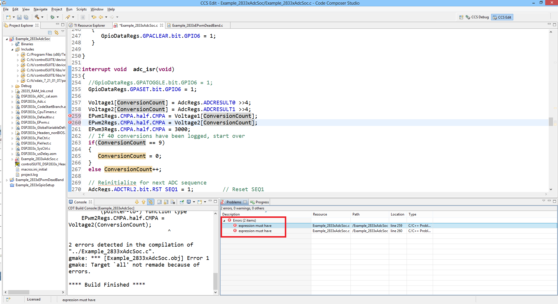

Hi All,
I am new to CCS5. When I try to debug my code and trace the source of problem I notice that unlike other compilers, CCS5 shows Incomplete text in its error log file. e.g. "expression must have ". I tried re-sizing the description text-box but it did not help, the only description I get is "expression must have". I was wondering if there is a way of making the description more complete (and helpful!). Any suggestions is appreciated.
Please take a look at the screenshot
Many Thanks,
Sam
  • There is a known bug in CCS that is likely the reason for the error description to be cut off in the Problems view. Please see this post for more information. The build console should still show the full text of the error so, in such cases, it is best to look at the console for the complete description.
