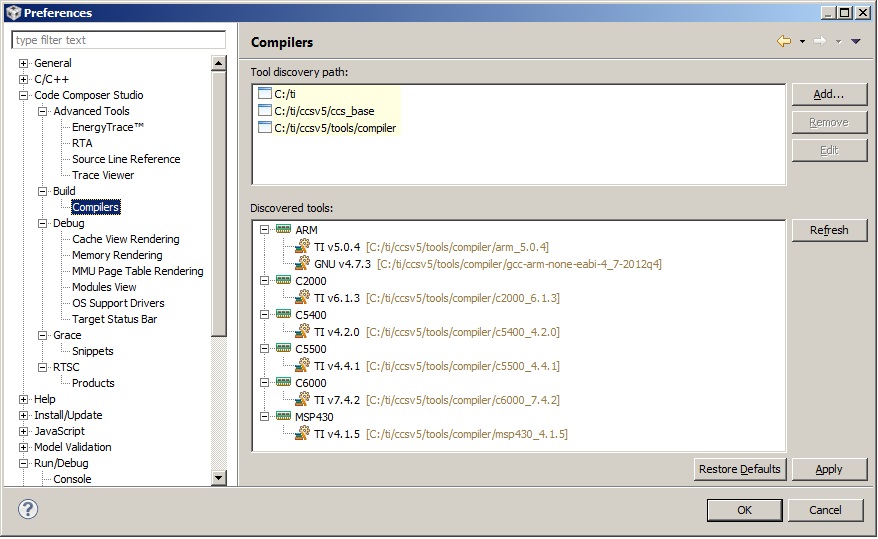

  • Levy Oliveira said:
    I found the ARM compiler installed, so I think its situation 1) of your last post.
    You may have found it, but it is apparent that CCS does not. That is the bigger issue. Please make sure the arm tools are found in the discovery list in the workshop preferences:
    http://processors.wiki.ti.com/index.php/Compiler_Installation_and_Selection#CCStudio_5

  • Hi, Ki,
    The CCS has found the ARM Compiler. See screenshot below.
    StarterWare is not shown, it should be there?
    Levy Oliveira
