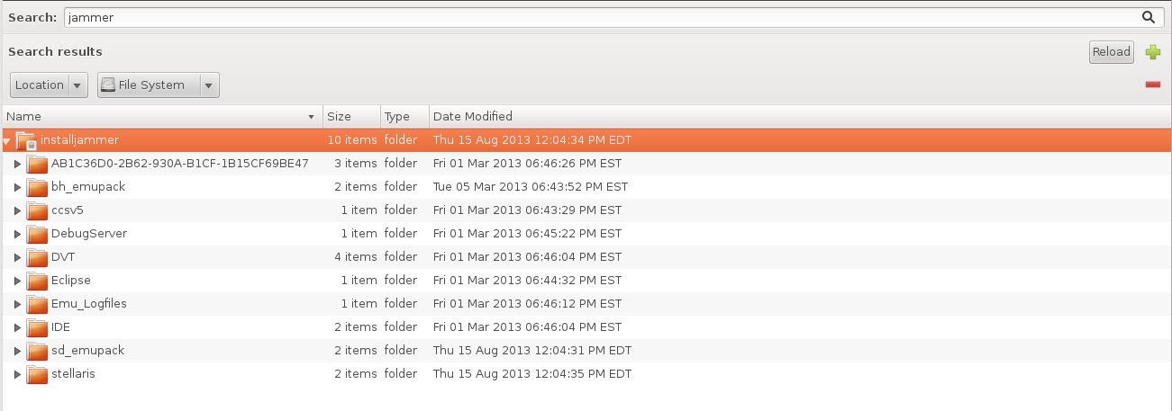

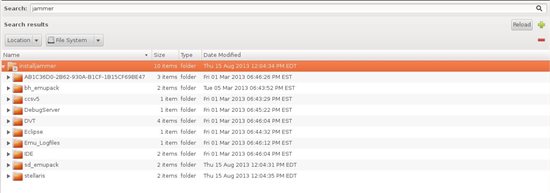

  • Hi Lisa,
                 Removed the ti directory: cd /opt, rm -r ti.
                 Under /var/lib there is a installjammer directory.
               Should I only remove the ccsv5 directory and/or the eclipse as well?
         John C.
  • Hi John,
    I would remove the ccsv5 folder to remove your installation.  I would remove all under the installjammerregistry directory folder.
    Lisa

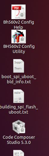

              After removing the ti and installjammer folders, installation of ccs_setup_5.4.0.00091.bin completed. The only
    issue seems to be in the user home directory, the shortcut icon shows "Code Composer Studio 5.3.0" in stead of
    "Code Composer Studio 5.4.0". Maybe some leftover artifact?
         John C.

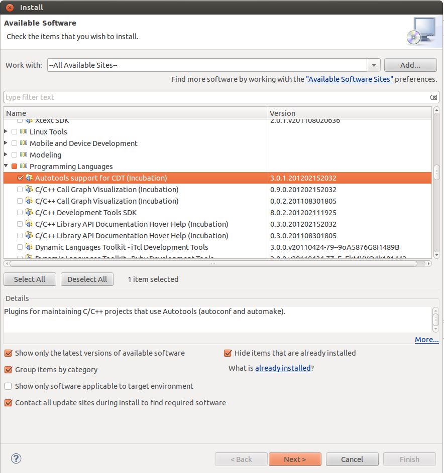

  • Hey Lisa,
                       I've been trying to get my remote search working again in Code Composer and I noticed that after this install, the software update no longer seems to be accurate.As an example I brought up the software install window and checked the "Hide items that are already installed". Then I checked Programming Languages->Auto tools to install what I assumed was a newer version:
         After trying to proceed I was met with this error msg:
    Cannot complete the install because of a conflicting dependency.
      Software being installed: Autotools support for CDT (Incubation) 3.0.1.201202152032 (org.eclipse.linuxtools.cdt.autotools.feature.group 3.0.1.201202152032)
      Software currently installed: Autotools support for CDT 3.0.1.201209170703 (org.eclipse.cdt.autotools.feature.group 3.0.1.201209170703)
      Only one of the following can be installed at once:
        Autotools Core Plug-in (Compatibility) 2.0.0.201209170703 (org.eclipse.linuxtools.cdt.autotools.core 2.0.0.201209170703)
        Autotools Core Plug-in (Compatibility) 2.0.0.201206111645 (org.eclipse.linuxtools.cdt.autotools.core 2.0.0.201206111645)
        Autotools Plug-in (Incubation) 1.0.2.201202152032 (org.eclipse.linuxtools.cdt.autotools.core 1.0.2.201202152032)
        Autotools Plug-in (Incubation) 1.0.2.201108301805 (org.eclipse.linuxtools.cdt.autotools.core 1.0.2.201108301805)
        Autotools Plug-in (Incubation) 1.0.1.201106060936 (org.eclipse.linuxtools.cdt.autotools.core 1.0.1.201106060936)
      Cannot satisfy dependency:
        From: Autotools support for CDT 3.0.1.201209170703 (org.eclipse.cdt.autotools.feature.group 3.0.1.201209170703)
        To: org.eclipse.linuxtools.cdt.autotools.core [2.0.0.201209170703]
        From: Autotools support for CDT (Incubation) 3.0.1.201202152032 (org.eclipse.linuxtools.cdt.autotools.feature.group 3.0.1.201202152032)
        To: org.eclipse.linuxtools.cdt.autotools.core [1.0.2.201202152032]
         It seems as if there already is a version higher than the one I selected. Could I have missed removing some other directory that is causing this issues now?

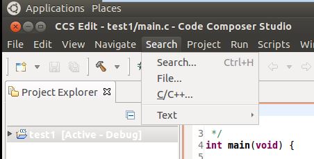

  • Hey Lisa,
                    All I really wanted was the remote search plugins which allow you to search beyond the workspace. I've found it
    very handy and it normally shows up in the search pull-down but is no longer there (should be below the C/C++), yet it
    shows it as installed.
         John C.
