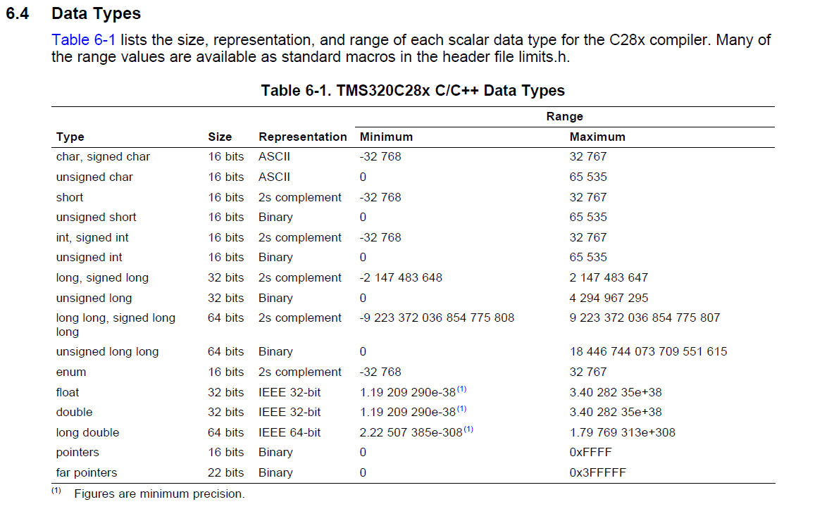

  • No it doesn't. The example is totally different. Sorry George but you're wrong.
    In a 32-bit 2s representation, a "signed long" number N is within the range:  [-231, 231 - 1]. This means its minimum value is -231 = -2147483648.
    Please see below, what the compiler User's Guide (page 92) says:
    Attached the mentioned User's Guide.

    Actually I've been able to make it work casting the S32_MIN to S32 (i.e. "long") explicitly: (S32)S32_MIN. Since S32_MIN is a perfectly acceptable S32 negative value, at this point I still believe the Compiler has a bug. Casting to S64 should never cause a 32-bit negative number to be converted into a positive one.

  • I'm sorry, but George is correct.  In C89, the language version the TI compiler supports, the expression -2147483648L is of type "unsigned int." That's because (according to ANSI 3.1.3.2 "Integer Constants"), "The type of an integer constant is the first of the corresponding list in which its value can be represented. [..] suffixed by the letter l or L: long int, unsigned long int.[..]" The value 2147483648L does not fit in a 32-bit long int, so it must be treated as unsigned long int, and therefore the negation operation is an unsigned negation. If you want an expression which represents the minimum value of a long int, either include limits.h and use LONG_MIN, or use (-2147483647L-1)
