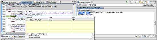

    here is one more issue with memory model migration but i feel this is a bug with compiler observe the figure below
    in above figure the ptr holds the address of 0x 0001 F01C which has value one but the 32bit adress is dereferencing  some other garbage value rather than the value 1 which is present in actual position
    what i suspect is the pointer de-referencing actually should happen to 0x1 F01C by ignoring the starting 3zeros more over the memory 0x0001 F01C is out of memory limit but how come it is getting a memory location

  • I do not see a bug here.  Assuming spx_int32_t really is a 32-bit type, you are performing a 32-bit read of the memory location 0x01F01C, which contains the 32-bit value 0x00010000, which is 65536, as reported by the expression window.  Don't forget that C5500 is a big-endian machine.
