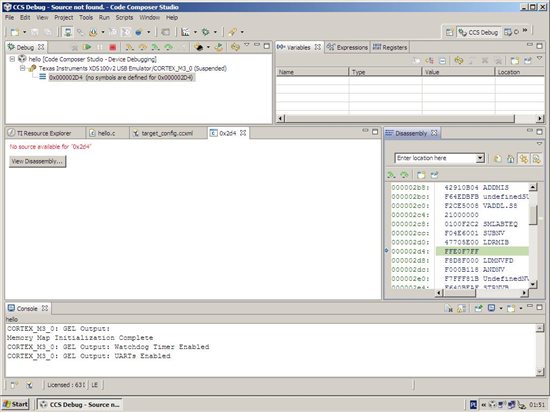

  •  Hi Lee,
    I have RDK - IDM - L35 board and XDS100 v2 emulator and ccsv5  program.
    My board shows qs-keypad program.
    I' like prgram my board with Hello World program.
    Builder works without errors.
    But  when I debug "Hello World program"  and connect the target, I get in console windows message:
    CORTEX_M3_0: GEL Output:
    Memory Map Initialization Complete
    CS_DAP_0: Error connecting to the target: (Error -151 @ 0x0) One of the FTDI driver functions
    used during the connect returned bad status or an error. The cause may one or more of:
    invalid emulator serial number, blank emulator EEPROM, missing FTDI drivers, faulty USB cable.
    Use the xds100serial command-line utility in the 'common/uscif' folder to verify the emulator can be located.
    (Emulation package 0.0.0.0
    There is message in debug windows:
    0x 000002D4 (no symbols are defined for 0x000002D4.
    There is nothing in Variable windows.
    There is :
    000002d4:  EFE0F7FF in Disassembly windows.
    There is :
    CORTEX_M3_0: GEL Output: Watchdog Timer Enabled
    CORTEX_M3_0: GEL Output: UARTs Enabled.
    in console Windows, before  push "connect target "
    What can I do with this problem?
    The best regards.
    Andrzej M
  • Hello
    have you see this FAQ?
    http://processors.wiki.ti.com/index.php/Xds100#Q:_I_was_following_Debugging_JTAG_Connectivity_Problems_and_I_a_-151_SC_ERR_POD_OPEN_error_with_Dbgjtag.
    In the future please start new threads instead of replying to existing closed threads. This will ensure the best chance that your question will be seen.
