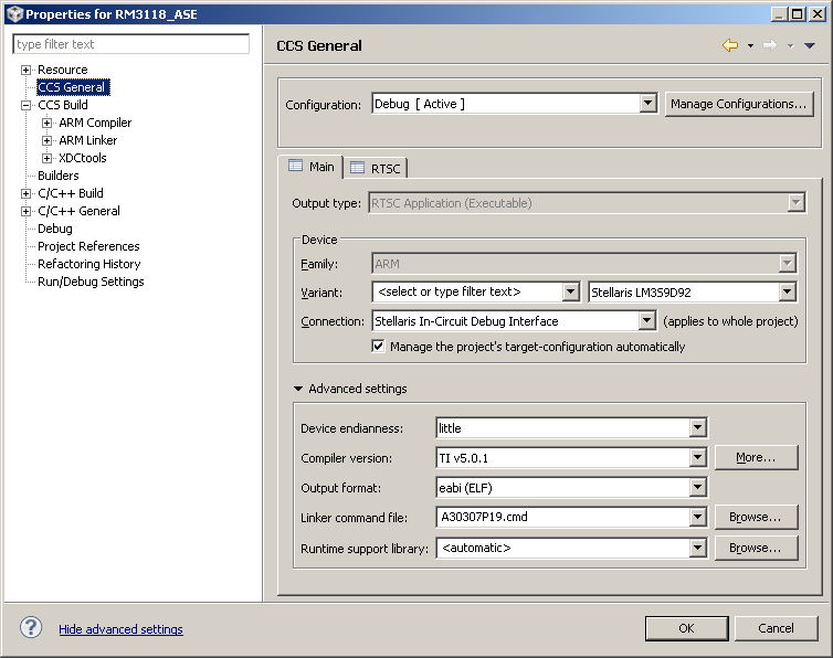

I am trying to create a sysbios application to load at a base addres of 0x00002000 instead of 0x00000000 so that I can use it with a bootloader application.  I have my own cmd file which specifies the new locations

However when I link this clashes with what says it is automatically generated linker.cmd in the Debug/ConfigPkg path of the project.

  • That's what I am doing with my own linker cmd file.
    But the TIRTOS stuff appears to have generated another command file under the debug directory which conflicts with my editied linker cmd file, even though I have specified for the project to use my linker cmd file as you suggest.
    If this is automatically generated, how do I move the base address for code and vectors so I can work with a bootloader?
    The file linker.cmd is automatically generated for SYS/BIOS projects and cannot be modified. As you can see from the linker.cmd some sections such as .vecs and .resetVecs are being allocated to specific addresses (in this case 0x20000000 and 0x0). These over-ride the .vtable and .intvecs sections specified in the project linker command  (lm3s9d92.cmd or your own custom file). as BIOS is just giving those sections different names.
    If you are OK with leaving interrupt vectors at address 0x0, and just want your app code to begin at 0x2000, then you just need to leave the memory range starting at 0x0 defined in your custom linker command file. So your MEMORY specification would be:
    MEMORY
    FLASH1 (RX): origin = 0x00000000, length = 0x00002000
    FLASH (RX) : origin = 0x00002000, length = 0x0007E000
    SRAM (RWX) : origin = 0x20000000, length = 0x00018000
    This should allow you to link and will place your app code at 0x2000 but leave the interrupt vectors at 0x0.
    If you want the interrupt vectors to also go to 0x2000 along with your app, then you would need to modify your custom linker command file to change the section name from .intvecs to .resetVecs, and load it to 0x2000. I have attached a reference linker command file here (renamed to .txt).

    A second part of the process would be to make sure that your linker command file is passed to the linker before linker.cmd in the command line so the section allocations are picked up first from your linker command file. To do this, go to Project Properties->Build->Link Order tab, click on Add and select  "Generated Linker Command files" and your linker command file. Then click on your linker command file and move it Up to be earlier on the list.
    In each case, please check the link map file generated to check if sections are being allocated to the expected memory regions.
  • Firstly thanks for the detailed answer, very easy to follow.
    This now gives me the correct map
