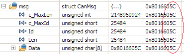

I have CCS5.4 installed. I'm compiling for AM335x with "-g -gdwarf-3 -gstrict-dwarf".
There is some problem loading debug info of local variables in some functions. CSS displays the following message: "Error: unresolved location: unknown Reg ID 0xffffffff".
If I compile with -gdwarf-2 instead, it works fine.
I inspected the dwarf info in both cases manually using the "arm-none-eabi-objdump.exe --dwarf Test.out" command. The info about these specific variables seems to be fine and same in both cases.
Any advice what the problem could be?
