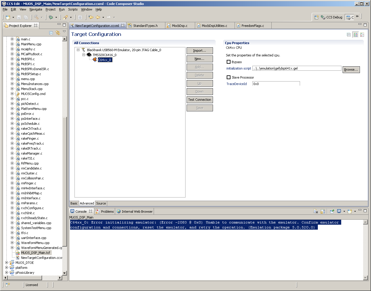

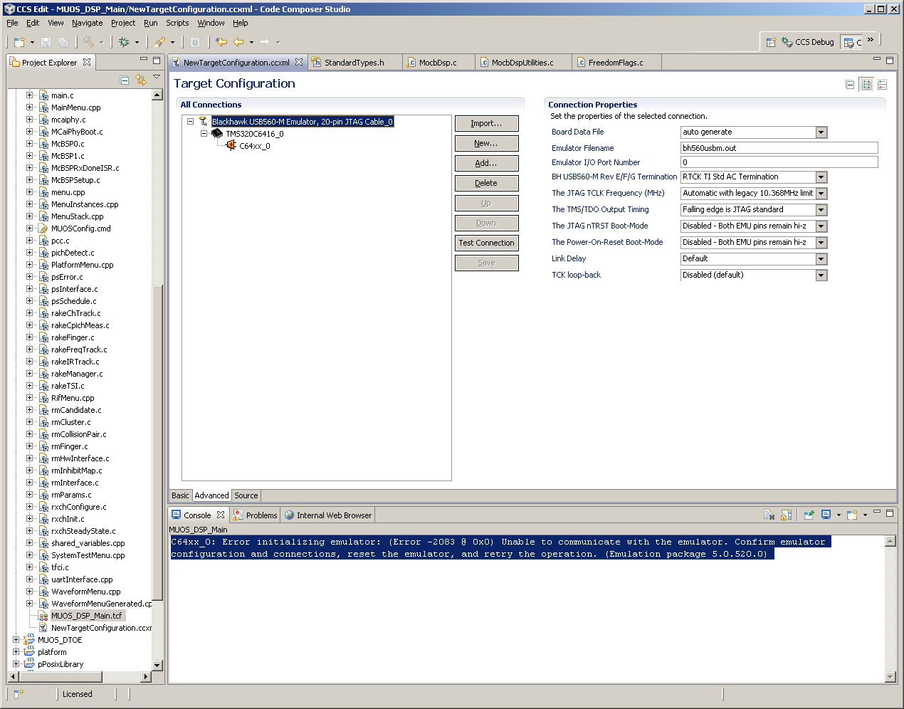

What am I doing wrong?  Heres my settings (hopefully these are visible):

    This error usually indicates the emulator can't be recognized by CCS, therefore I suggest checking this other thread where there are several tips to further debug this.

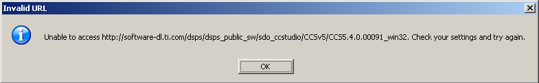

    When we try to run the patch install, we get the following error:
    Any ideas here?

    Regarding the error message you got, I am not 100% sure why it can't retrieve the file. At first glance it seems to be missing an extension .exe or .zip on the link, but I am not sure if that is the root cause (the message may be truncated). If it is a network issue, sometimes a proxy server configuration must be done (for Windows systems the installer usually uses whatever is configured in Internet Explorer) - if you are able to connect to any internet URLs, then the updater itself is at fault and the direct download is the way to go.

    Since you mentioned your fear of setting something wrong, would you mind sending the .ccxml file?

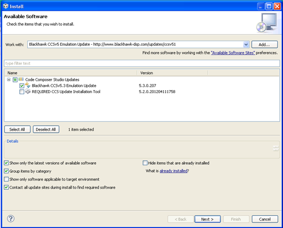

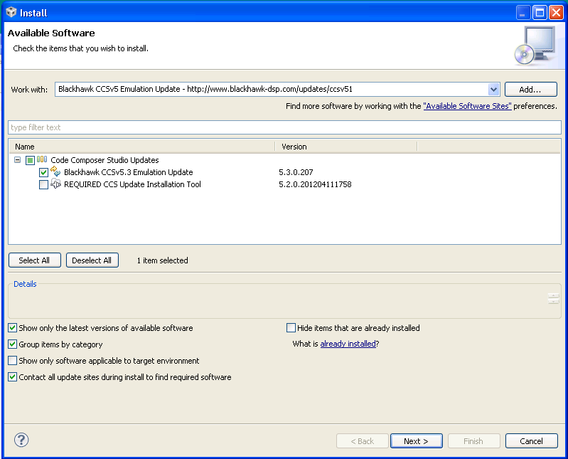

    Also, I just noticed the emulation pack version you are using (5.0.520.0) is really old and you are possibly getting the same problem regarding Blackhawk emulation drivers as shown in the thread I sent before. Can you try to update just this component and see if you are able to connect?
    To do this, go to menu Help --> Install New Software --> and then make the selections as shown below.
    Rafael
  • OK!  We were finally to get everything updated to 5.4 and what not, and the issue is resolved!  Seems whatever the issue was in getting the emulator to work correctly, was resolved in a later than 5.1 fix.
